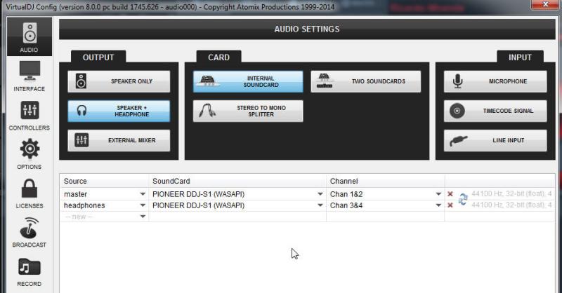

i need a screenshot of the Audio Setup with ASIO and the details from the right side visible if possible. thanks

That is what I have up top for my audio set up

Can you drag out the right hand side - need to see everything in the righthand box. ;)

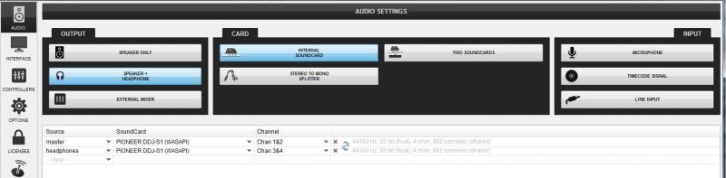

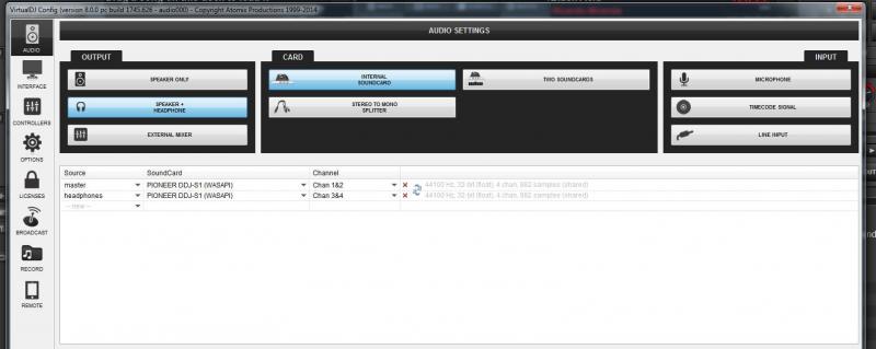

Posted Sun 11 May 14 @ 5:21 pm
this should be easier to see
Posted Sun 11 May 14 @ 5:24 pm
I think the forum is resizing images now.
Posted Sun 11 May 14 @ 5:29 pm
It always did. Anything more than 800pix wide gets resized
Posted Sun 11 May 14 @ 5:31 pm

Maybe make a PrntScrn and then edit it down to just the right side then.
