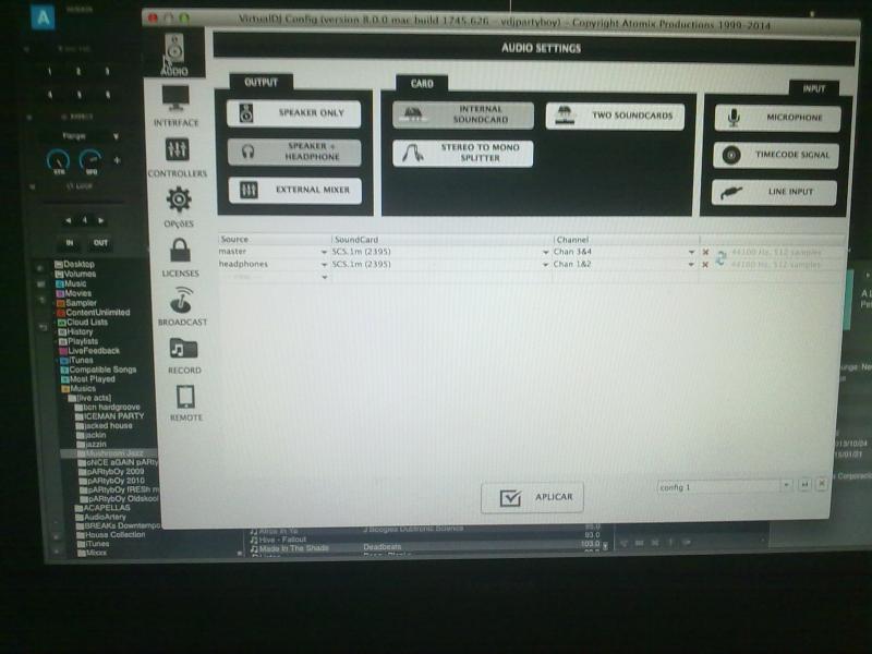

Hi there just downloaded the new pre-release VDJ8,I managed to configure the audio output to my mixer scs1m,but I cant use the MIDI controls,how do I add the SCS1d deck and the SCS1m mixer to control the software?

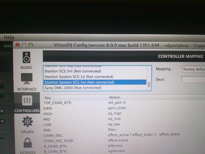

Controller SCS1m is recognized for sound but not for any type of MIDI control ,also the SCS1d deck.

I'm afraid there are issues with the SCS.1 system at the moment on both Mac and PC.
Posted Mon 12 May 14 @ 4:52 am
the SCS1m is only detected as a soundcard,its not detected/connected as a MIDI Device SCS1d or SC1m.

Correct, they are not detected on a Mac. The SCS.1d's also have platter issues at present.

new build but still no firewire controller detected has a MIDI device,only the mixer is detected as a soundcard.

We are aware of the issue :)

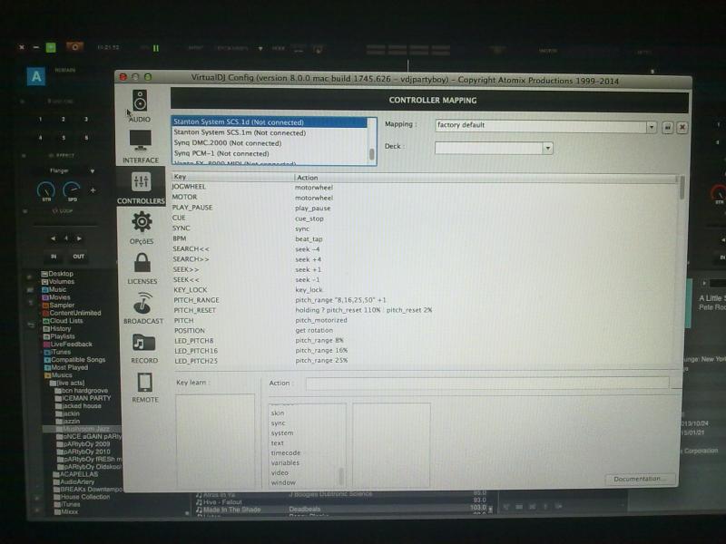

just tried the new build,and it works on SCS1 system! just add to turn on MotorWheelInstantPlay-yes; and tweaked MotorWheelSmoothPercent by default was 75,used 100, now I'm using 200, "feels" much better, the track doesn't "jump" has it did on VDJ7.,the VU meters on the scs1m work much better,the FX and filter "shifts" dont work,and the LCDs on the deck are off also the deck select(1,2,3,4) LCD is off, I guess I have to edit the mapper,very looong hardwork ahead...

right,they run perfect in Traktor. probably its a VDJ problem! I'm confused now, I just noticed exactly what you said about running VDJ7 then VDJ8,I have testing the deck and mixer, switching between softwares,Traktor Pro2 with daRouter,closed TP2+dRouter,opened VDJ7.41,tested,close vdj7 then and VDJ8,and sometimes it works OK,sometimes I got platter issues, very bad ones, but always fine in VDJ7 and TP2.so still some work on the deck,platter issues,LCD windows off,no text, Deck indicator off.
