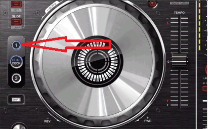

What skin are you using?
And make sure you "unlock" the decks.
It seems as you set it to dual deck.

when the controller is plugged in i have decks 1 and 2 lit up the dual deck button isnt illuminated

Make sure that you are using the most up-to-date mapper for the DDJ-SX. The original had an issue when using 2 decks due to the fact that decks 3&4 of a 4 deck controller will 'wrap' back around to decks 1&2 when using a 2 deck skin.
An updated mapper was originally released to address this problem, but it's now native in the latest VirtualDJ v7.4.1
Make sure that you have the latest version v7.4.1 of VirtualDJ installed and then revert the mapping back to factory settings (Make a backup of any custom mapping that you have created first.)
If you are using a custom mapper created by a user, then they will need to update it to avoid the wrap-around issue, or alternatively, you will need to use a 4 deck skin. The most recent mappers for DDJ-SX can be downloaded from the following page: https://virtualdj.com/addons/controllers.html?category=best&order=default&search=sx
