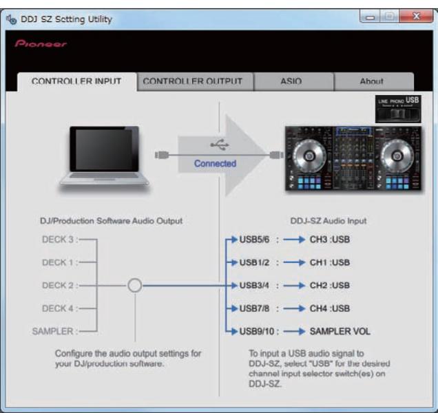

Not quite understood your issue, but will try to provide a few more information.
The DDJ-SZ has actually 5 different stereo output channels. Channels 1 to 8 are routed to the 4 CH of the mixer and the 5th one (Ch 9& 10) is routed to the internal Sampler channel of the mixer.
So you have 5 stereo outputs to route whatever you want. This could be Decks, Sampler and Headphoones of course, in case u need to use the internal prelisten player of the softwares.
Example.
Deck 1 .. ASIO DDJ-SZ .. Chansl 1,2
Deck 2 .. ASIO .DDJ-SZ .. Chans 3,4
Deck 3 .. ASIO DDJ-SZ ..Chansl 5,6 (optional of course i f you just work with 2 decks)
Sampler .. ASIO DDJ-SZ .. Chans. 9,10
Headphones.. ASIO DDJ-SZ Chansl 7.8 (you lose a deck here in case you works with 4 decks)
Routing Sampler to 9,10, it will provide you the ability to control its Volume with the VOLUME knob on the right side of the mixer. (but the Parameter knob will not work opf course)
Having Headphones as a Channel assigned, it will also route Sampler in to the Headphones "Deck"
Hope these make sense to you.
PS. It would make sense to me to route VirtualDJ Sampler to Deck 4 ... (Sampler... ASIO DDJ-SZ ... Chansl 7.8). It will provide you the ability to use the 4 Master Effects too (Filter, Jet etc) along with EQ, recording etc. ;)

Okay I will try this I don't use mix 4 decks very much anyway so I will route headphones which includes the pre-listen to channel 4 this will all me to cue it to my headphones only. I can't use output 9 and 10 as it will play the pre-listen through the mains for everyone to hear.
I will send the sampler to channel 3 this will allow me to control the volume of the samples as the sample volume is currently non responsive.
The only draw back with this is being limited to 2 decks.
What would be idea is if Pioneer made a routing table in their utility program for such applications as mine. They do this for the inputs but not the outputs. If this feature was available I would route outputs 9/10 to the headphone/booth outputs of the DDJ-SZ and the problem would be solved.
Posted Tue 29 Apr 14 @ 2:56 pm
Okay this works:
with headphone in channel 4 volume done and cue on, sampler in channel 3 I now have pte listen, sampler with volume and 2 decks running. Wish I could get all 4 fecks running but oh well I can function like this.
