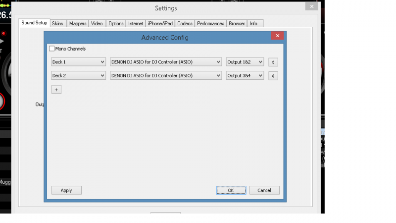

I\\\'m having an issue with audio playback using the MKII. I\\\'ve had the mc6000 since it was released and just bought the MKII. It doesn\\\'t seem to have the internal usb mixing that the MKI had. I cant get audio to output to channel 2 and crossfader isn\\\'t working. I AM using the MKII mapper.

You need to have Master/Headphones in the Sound Setup. Just a reminder, as the Sound Setup picture above is incorrect.
Also keep in mind that depending on the XF-LINK position, the crossfader of the MC6000MK2 controls, the Audio,, Video or both crossfaders of the software.
