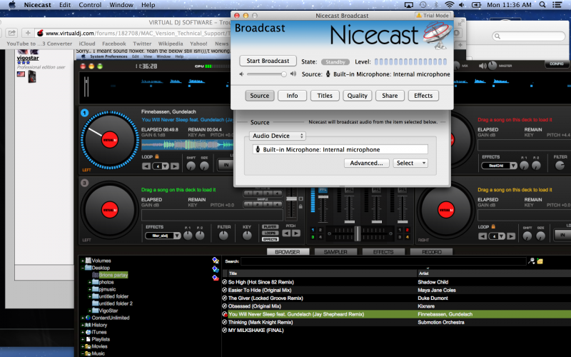

Im still having issues broacasting. My set-up is Macbook Pro, VDJ Prof and a Denon MC6000. I am using Nicecast to communicate w/ spreaker, connecting from my booth out as per -~> http://www.virtualdj.com/wiki/Recording%20your%20set%20or%20broadcasting%20when%20using%20an%20external%20DJ%20mixer.html
and going into the Macbook's microphone (which is the only audio port I have, and Ive switched it, i think to an audio in) and Nicecast still doesnt pick up the audio.
Does anyone else have a work around using any Broadcasting site or connecting the devices differently?

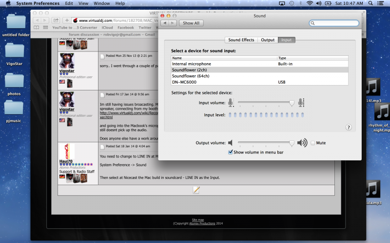

You need to change to LINE IN at Mac OS side.
System Preference -> Sound
Then select at Nicecast the Mac build in soundcard - LINE IN as the Input.

Im not getting that option.. All Im getting is
Internal Microphone
Soundflower (2)
Soundflower (64)
DN- MC6000
Internal Microphone
Soundflower (2)
Soundflower (64)
DN- MC6000

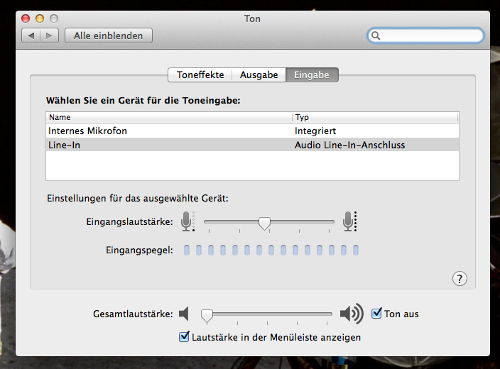

On Tone side you have to select first OUTPUT and then selest LINEIN.
Not sure what kind of MBP you use, but on MBP Pro side you can switch the input stacj from MIC to LINE IN that way.
After that you have too select in Niccast side the buildin sound card and there you should see also the LineIn.

Sorry.. I meant sound flower. Yeah the below still isn\\\'t working.... Nicecast still isn\\\'t picking up the sound on my end...

It looks strange to me, you only can select between Mic input and sunflower and not to see the "normal" switch to LINE IN like on my side.

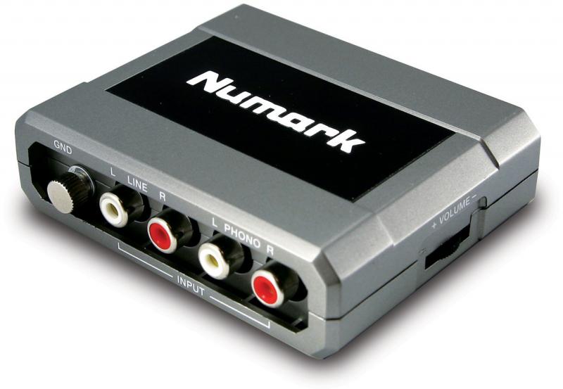

Do you know if its possible to connect an external soundcard?
Posted Wed 22 Jan 14 @ 9:48 am
What if I used something like this?
Posted Wed 22 Jan 14 @ 9:55 am
Sure, because the MC6000 is a external soundard too ;-)
