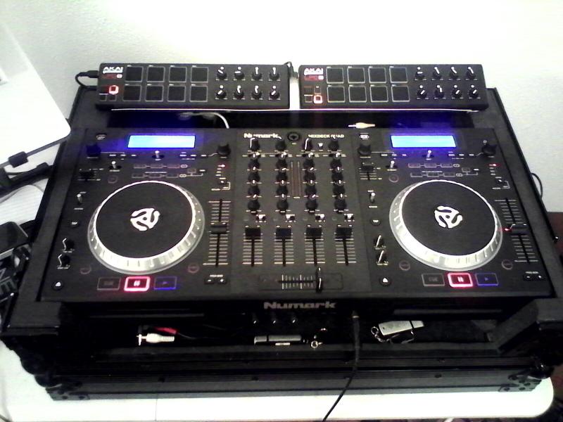

And here is the finished product,
Thanks again bro!!
Thanks again bro!!
