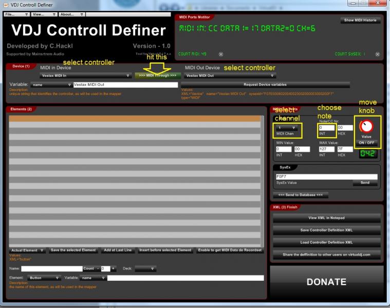

Download the definer tool and check it out manually.
https://virtualdj.com/addons/12994/VDJ_MIDI_Controll_Definer.html
