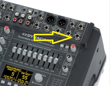

the dynacord powermate 600-3 however i just noticed that this mixer doesnt have a headphone socket
Oh yes it does! Well the one pictured on the product page of the Dynacord website does. It also has PFL buttons so you can cue properly.

Found the headphone socket
Posted Thu 01 Aug 13 @ 6:57 am
