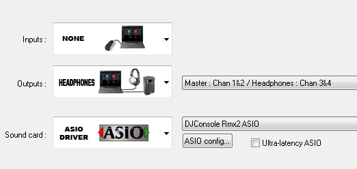

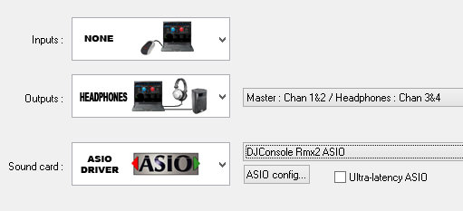

Here is the standard audio configuration to use for the Rmx 2, which is the same as you would have seen with VD LE:
Posted Mon 08 Jul 13 @ 6:38 am
Okay, I have tried uninstalling the drivers and reinstalling them, still with no luck. DJ Phatso's image of the sound setup page is what it looked like when I was using the limited version. Now in the soundcard box the only time I see my Hercules RMX2 is in the simple congfiguration, it wont show in the ASIO. I have controll of my console to some degree. I heard someone say to uninstall the drivers while the RMX2 is still pluged into my computer and then turn off the RMX2. Then install the drivers. I ain't bugging with anything until I here from this forum first.. If anyone is in the Scarbourough,Ont area, I will pay you to resolve my connection problems. In need of help.

Example 1 - Internal mixing (default configuration)
Here, you are telling VDJ to use Output 1-2 for the Main Mix and Output 3-4 (which is also the headphone outputs) for preview since you are mixing from the software, using the console to control it.
This means that:
- speakers connected to Output 1-2, in either RCA or XLR will send out the same signal.
- if you do connect speaker to Output 3-4, you would hear exactly what you get in the headphone.

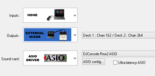

Example 1 - External mixing
Here, you want VDJ to act as a 2 deck MP3 player. Deck A sends to Output 1-2 and Deck B sends toOutput 3-4. Mixing and headphone preview will be done from an external mixer.
This means that:
- the Rmx2 act as an audio interface to send the audio signal from the computer to the mixer
- you would not connect headphones to the Rmx2 since preview is done from the mixer.
