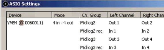

Pages 17 & 18 of the American Audio VMS4 manual explains how to set the Audio Configuration of the VMS4 drivers.
Link to the manual - http://www.adjaudio.com/pdffiles/vms4.pdf
For a 4 deck audio configuration (8-out audio configuration) change the MIDILog output to match the following:
Channel Grp ~~~ Left Ch ~~~ Right Ch
MIDILog 1 ~~~ Out 5 ~~~ Out 6
MIDILog 2 ~~~ Out 1 ~~~ Out 2
MIDILog 3 ~~~ Out 3 ~~~ Out 4
MIDILog 4 ~~~ Out 7 ~~~ Out 8
Now the mapping will match.
Btw, if you are only running 2 decks then your audio configuration switch (on the front of the console) should only be on 4-out not 8-out. 8-out is only necessary if you are running 4 decks.
In 4-out the default audio routing is MIDILogs 2 & 3 are Decks 1 & 2 respectively - which matches the mapping.

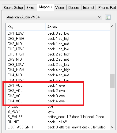

joshu.duncan wrote :
Please open your asio control panel and check either you have a 0 or 1 as leading digit in the upper left corner next to the text vms4
If there is a 1 you needn't read the rest otherwise I recommend you to read it..
If there is a 0 that means your vms is running in pre eq mode.
There are 2:
0 = pre eq mode
1 = post eq mode
In the pre eq mode the vms mixer section acts as a "normal" analog mixer. Meaning that the sound is mixed and modulated IN the vms.
In the post eq mode the vms behaves like a pure midi device. Mixing the sound is then up to the software.
Now the point:
If you use the mapping like in the first picture vdj and the vms will do sound operations what will double up the effect of EQ or volume faders. This could, and may, lead to bad and/or distorted sound.
Therefore it is recommended to use the "fake" commands. Just add a "fake_" infront of the current mapping commands.
E.g: fake_eq_low, fake_eq_mid, deck 1 fake_volume etc....
With this fake commands vdj will do nothing to the sound, but you still get an optical feedback which knob or fader you are using.
In other words, everything is still moving on the screen if you push sth. on the vms.
