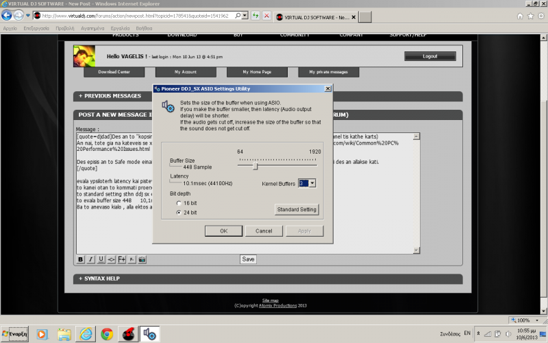

Des an to "kopsimo" stamataei me ypsiloteri timi sto latency tou ASIO (apo to ASIO COntrol panel tis kathe karts)
An nai, tote gia na kateveis se xamilotera epipeda latency prepei na peraseis apo edw.. https://virtualdj.com/wiki/Common%20PC%20Performance%20Issues.html
Des episis an to Safe mode einai energopoiimeno sto CONFIG-->Performances. An einai, apenergopoiise to kai des an allakse kati.

evala ypsiloterh latency kai pisteya oti to provlima ly8ike mexri poy piga stin anazitisi kai nato pali.
to kanei otan to kommati proerxetai apo anazitisi.
to standard setting sthn ddj sx einai buffer size 256 5,8msec bitdepth 24bit kernel buffer 3
to evala buffer size 448 10,1msec bitdepth 24bit kernel buffer 3
8a to anevaso kialo , alla ektos apo ta msec prepei na allakso kati allo

h diakoph hxoy ginetai meta apo anazitisi kommatioy akoma kai sta 30msec kai exei emfanistei nomizo den eimai sigoyros sthn ekdosh 7.3
kai 7.4 poy allakse h anazitisi prin den to eixa, me ton idio akribos eksoplismo.
diladi exeis fotomeno ena kommati sto deck ena kai pezei kai pigeneis kaneis anazitish perneis to tragoydi kai molis to afiseis gia na to fortosei
kanei mikrh diakoph hxoy

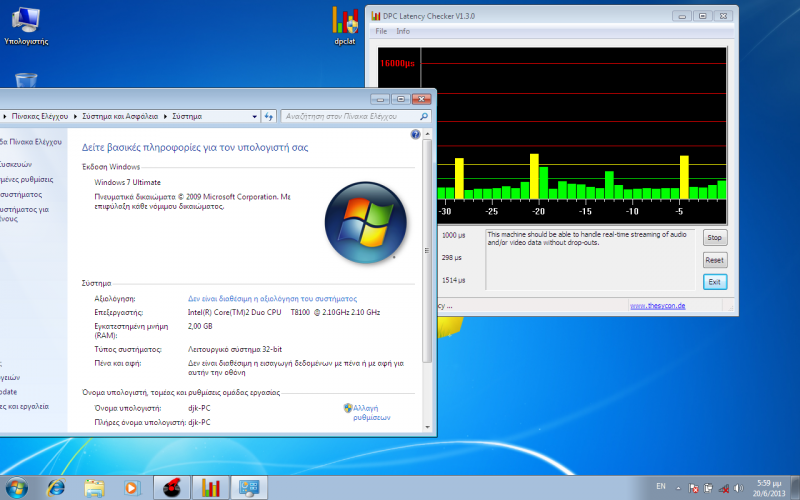

Ara den einai thema anazitisis. Otan kaneis Search den exeis kopsimata. Kopsimata exeis otan to fortwneis sto deck , swsta ?
Gia trekse to DPC latency checker kai des ti xrwmatakia pairneis . Btw, apo edw perases ? https://virtualdj.com/wiki/Controller%20Configuration%20And%20Troubleshooting.html (sto link auto tha vreis kai link tou DPC latency Checker)
To safe mode einai disabled sto Config->performances ?
To Latency sto idio parathyro sto Auto ?
Sto Sound Setup tsekarise to Ultra Latency
Xrimopoieis eswteriko i ekswterko disko ? Exeis to idio thema akoma ki an to tragoudi pou fortwneis einai ston eswteriko ?

To dpc latency checker deixnei arketes kokkines kai kitrines mpares, episis xrisimopoiw eksoteriko disko.
Epimenw omos oti to problhma emfanizetai sta kommatia poy erxontai apo anazitisi.

Oi kokkines grammes prepei na fygoun. Oi kitrines den einai kako, alla kalo tha itan na eixes mono prasines.
Auto pou prepei na kaneis, einai na apenergopoieis mia mia tis syskeues apo to Device Manager kai na vlepeis an veltiwnetai i katastasi.
Ksekina apo to Wifi, Battery ACPI Manager, Webcamera, Karta Ethernet kai meta vlepoume.
Episis apenergopoiise ta Aero graphics (an einai energopoiimena)
Fysika ennoeitai oti tha prepei na apegkatastiseis Antivirus kai alla perita bloatware programmatakia pou mporei na trexoun apo pisw. Rikse mia matia sto Task Manager
Poia einai ta xaraktiristika tou ypologisti sou (CPU, RAM, Karta grafikwn, Leitourgiko), gia na exoume kai mia eikona ?

kokkines grames emfanizei to bacup labtop to labtop poy paizo den emanizei ka8oloy kokkines
edo kai ta xaraktiristika apo to labtop poy paizo
malista ekatsa kai to ekana format kai kanei pali to idio

Afise to DPC latency na douleuei sto background kai des an anevazei kokkina stin periptwsi pou syndeeis ton eksoplismo sou (skliro disko, karta ixou, controller klp).
des episis an pairneis kokkines grammes, kathe fora pou kaneis anazitisi
H karta grafikwn tou ypologisti poia einai ?
Stin 7.4 dokimase ... Apenergopooisi Colored waveforms (apo Options) kai min kaneis to skin maximized an den einai akrivws idio me tin analysi tis othonis sou.
Mporeis na exeis kai tis dyo egkatestimenes, arkei na metonomaseis ta exe files. Px.virtualdj705.exe kai virtualdj74.exe
