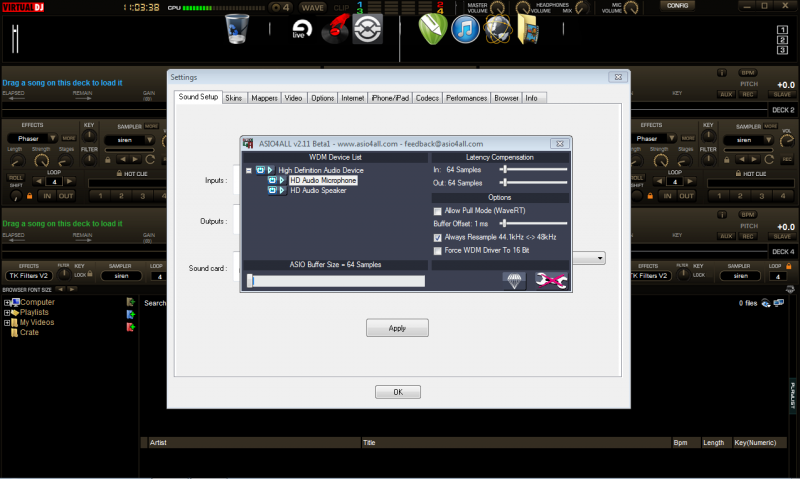

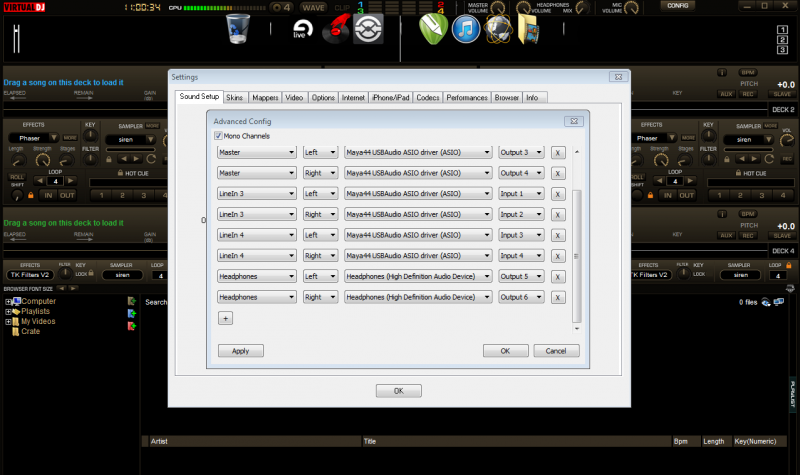

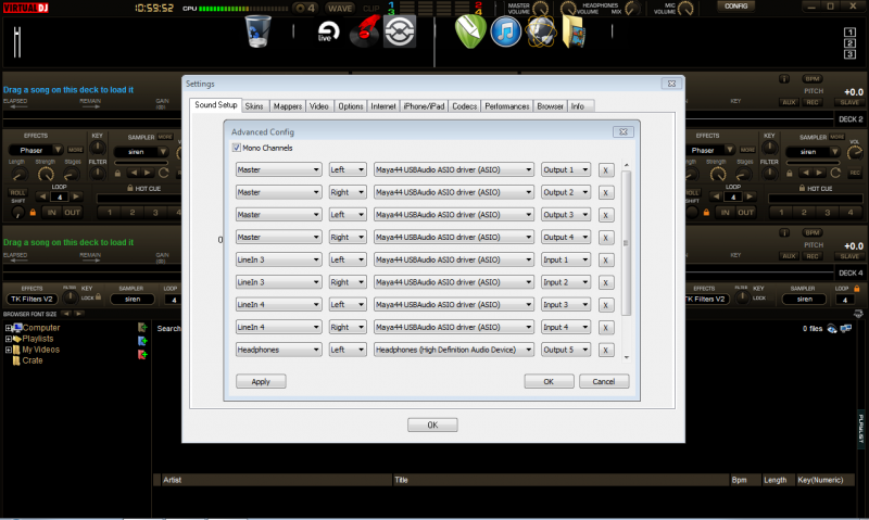

Using 2 sound cards, first card is internal on Realtek drivers, second card is Maya 44usb on newest driver version 2.953
So, basically at the moment I'm not using equipment. I'm running my laptop on 2 different sound cards, internal card with asio4all for my headphones, Maya for main output to monitors. Everything works for the most part well, except if I load a song on a deck or after play for a bit my headphones can start to crackle. And also not always, but sometimes the CPU level reaches red and that will also make them crackle. Usually I will go into the settings and uncheck or check e.g equalization or bass etc... And that will reset my headphones, needless to say it's annoying.
This happens with or without wireless internet on which I know affects latency at times, or antivirus on off also. I've tried disabling some services to see if that makes a difference and nothing, what could I try to make it stop? Here are some examples maybe I just have things setup wrong. By the way I also run sequencers and drum machines through the inputs which is on aux, so I don't think that bothers anything
