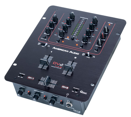

Im looking at the American Audio DV2 USB mixer because its crossfader does send a midi signal.

The DV2 is a MIDI capable mixer, so all you need to do is map its crossfader to video_crossfader to allow you to control the video crossfader in VirtualDJ. Please see http://www.virtualdj.com/wiki/How%20do%20I%20map%20my%20MIDI%20controller.html
NOTE: When using a real hardware mixer, you should not map the EQ knobs, volume, etc. Just map the crossfader only for video crossfading. Please see http://www.virtualdj.com/wiki/MIDI%20mapping%20an%20external%20DJ%20mixer.html
