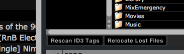

Is there a way to relocate moved files?
I've moved some files around on my drive "organizing" and now my playlist are jacked saying tracks are not found.
I have "checked,cleaned and fixed" but nothing.
I know there is a way in Serato to do this but not sure in Virtual Dj.
This is the serato way
Just would be helpful if there was a way for this to happen.
Thanks for the help.

have you tried to re scan the database so VirtualDJ could relocate the files?

On that, if you ever move files around, try and do it from inside VDJ.
If will not only move the files, it will also move the database info to the database on the new drive.
But playlists and virtual folders need to be manually repaired even if you do the above.

For anyone else who encounters problems with file path changes breaking play lists, database etc. You can always create a junction point in Windows to point old directories to new ones if moving an entire directory. Alternatively get yourself a good text editor e.g. Notepad++, open all XML files used by VDJ at the same time! and search replace any old paths with new ones. Best to do this with VDJ closed. Might want to BACKUP the VDJ config folders first just to be on the safe side.
You could probably write a script to do this fairly easilly using a file of changes to be made and then search replacing all paths in a single click of a batch file or VBS script etc.
Hope that helps until VDJ add the missing function.
I would have assumed a simple function could scan your drive for files that's paths no longer exist. Create an array of all subfolders in each music location and check each whether each missing file exists at one of the sub folder locations. That's how I'd solve it as there are likely to be a lot less folders to check that individual files.
