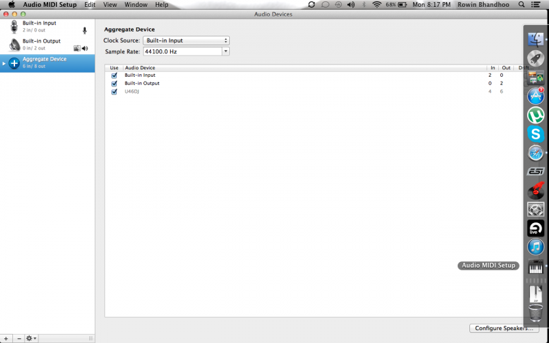

by no means im a pro at this but i had somewhat a similar problem running my u46dj soundcard in time codes if i needed record loopback ..what the best advice i got was to go to UTILITIES>AUDIO MIDI SETUP>CLICK THE BOTTOM + SIGN and create an aggregate device. make sure all the sample rate is the same as the soundcard and check all the boxes sound input,, sound output and soundcard itself ...maybe thatll help .. cheers
p.s i attached the pic of my screenshot

Thanks for looking and the info but that didn't work. I really think it has something to do with the soundcard being 48Hz and the Mac and VDJ or the Mac or VDJ cant handle it. The weird part is, on my PC its flawless!! Shit works PERFECT but I don't wanna use my PC cause its only a Core 2 Duo 2.2 and theres no syphon for pc's and my Mac's got an i7............ Hopefully someone can give me an answer in the near future and if it is only the soundcard well 8 needs to hurry up cause if I remember right VDJ will be able to handle any type Hz.............
