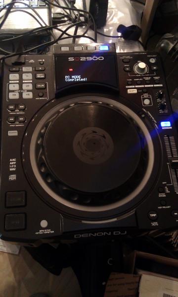

Another problem that I'm not sure if is a setting on the deck or in VDJ, it seems like the 2900 on the right that is controlling the "deck 2" in VDJ doesn't kick over to..uh..what to call it..."lit up" mode? I switch it to MIDI/NORMAL and it connects to the PC. The deck actually controls deck2 in the software, but the deck doesn't light up...it just stays with "connect success" on the screen and the platter ring, buttons/etc don't light up. Do you know what I mean?
I'll attach a cell phone pic I took last night....
I won't be able to try out the settings until this eve (STUPID DAY JOB)

Yes, I just found the chart on the Denon forum and was about to post the same answer - v2.22
I have to hack my way in to their forum now via a proxy, as they banned me for spam (which I never sent) from an IP address (that isn't mine).
As for the "dodgy deck" - has that got the same firmware as the one that's OK? It was mentioned above that the LED rings needed a f/w update.
Posted Fri 10 May 13 @ 9:37 am
