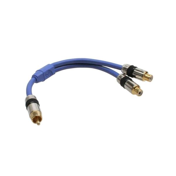

Do you want to connect the sub and your speakers...? Then use this kind of adapter for each of your stereo outputs ...
greetz
rob
