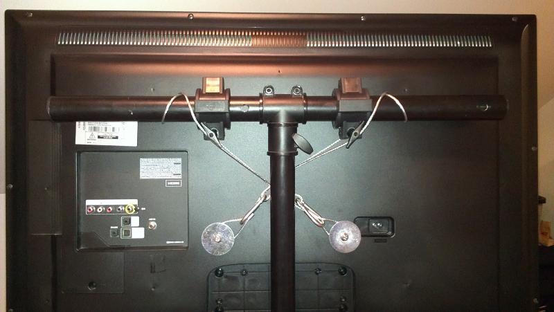

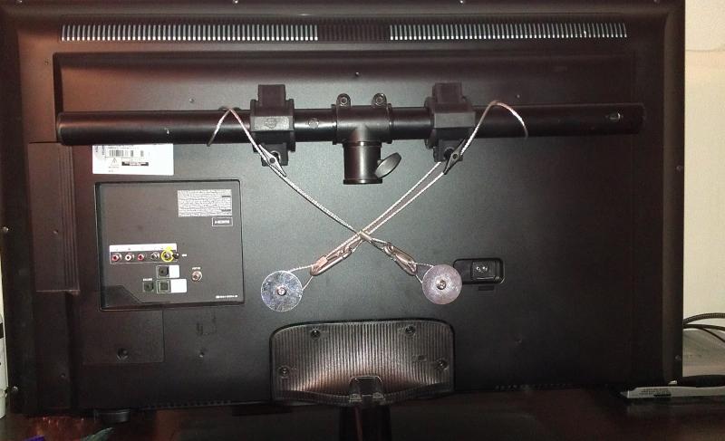

Now, here is the mount with safety cables. The pole is from an "On Stage Stand" (brand) Lighing tripod, cut down to 26 inches wide. The safty cables are standard 31 inch Lighting safety cable. I used M6 Flare head bolts (6 MM, 1.00 pitch, 16 MM long) with 1/4 inch hole, Fender washers (about 2 inch outside) and tightened the cable loop snug to the back of the TV (loctite on the threads).

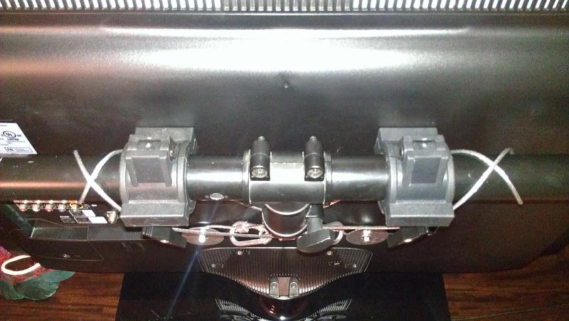

I have M6 flare head bolts (6 MM, 1.00 pitch, 20 MM long) going through these standard plastic Lighting O clamps and directly into the TV. Use metal washers on the blot head (you may have to grind the edges of the washer to fit inside the clamp). Loctite the threads before treading into the TV.
I leave the Bracket on this TV all the time and just place the tripod pole in the the Plastic T head fitting, in the middle here. So the only thing I have to tighten is the the Wing bolt on the T adaptor of this tripod head.

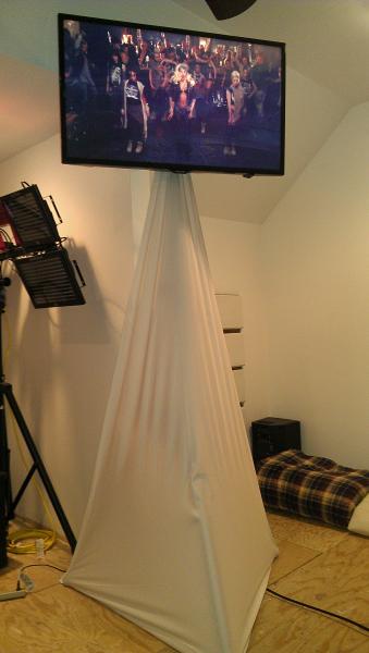

Finished design 8ft in the air with my 2 sided Lycra stand cover.

USE THE DESIGN AT YOUR OWN RISK!!! I ASSUME NO LIABILITY OF DAMAGES, FAILURE OR INJURY. This is just to show you how I did it. DO NOT cut corners or buy cheap hardware. You should also have DJ insurance if you are going to have large objects haning over head. Drunk people trip all the time, all it takes is 1.
