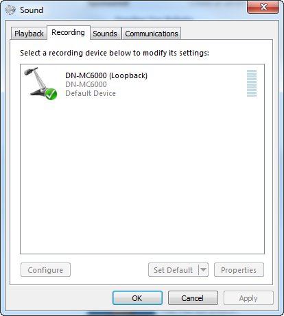

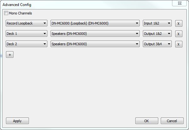

Sorry for not responding sooner... Keith did ask, but I've been very busy.
As Keith says I use Virtual DJ to broadcast all the time. I posted these pictures and comments on the MC6000 group on Facebook to help others with a broadcast set up so hopefully this will help you too...
The first thing to remember is that the MC6000 is an analogue mixer, so if you use a Mic you need to route that audio back to Virtual DJ. To do this you need to set up the Record Loopback (see below). This will route all audio "master out" back to Virtual DJ.
Virtual DJ will then use the Record Loopback for the broadcast.

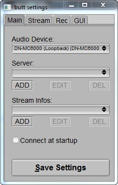

Because you currently cannot broadcast and record at the same time, I use the FREE Broadcast Using This Tool (BUTT) application to record. However you could also use it to do both and not use Virtual DJ at all.
You can see how the MC6000 appears to BUTT in the image below.
You can download BUTT from here
The image below shows how the DN-MC6000 appears as a Windows recording device.

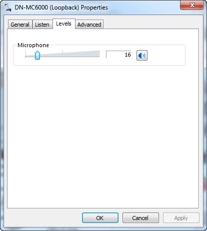

Finally use this access this dialog from the Properties button when you select the device from the above. As you can see I set the input level quite low. This (for me) was an optimal setting for both VDJ to broadcast and for BUTT to record.
Hope this helps,
Roy
