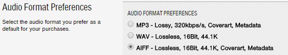

I know this is an older topic, but does anyone know of a good way to tag AIFF files to read in VDJ? I have a bunch of Beatport stuff and don't want to globally get information from file name.
Posted Mon 01 Dec 14 @ 8:42 am
Well, some digging on this subject in the past 24 hours turns up this. All my AIFF files currently do have fully populated Metadata. Mixed In Key can even write to them too. Long story short, it is only VDJ that can't read the AIFF metadata.
Not going to use FLAC because it is not supported in iTunes. So I can't organize those tracks into my iTunes playlists. ALAC is at least a compatible lossles compression. But compression is compression, FLAC and ALAC is still compressed even if it is lossless. These are my scratch sentences and some other special tracks. So I want uncompressed to reduce PC workload in attempts to reduce latency / drift.
Last, the previous posts (myself included) were wrong about global get info from file name. Because VDJ can't get the AIFF metadata, it will take the file name without selecting anything globally. Just format the .WAV or .AIF file name as "Artist - Title" and VDJ at least will fill out the Artist and Title. VDJ will leave out remixer title information between brackets " ( ) ", so you can leave that out of the file names. Then at least your searches will work on these types of files after potentially unknowingly erasing your tag data in the VDJ database during a library "Reload Tags"...
But AIFF is pro quality uncompressed with metadata support.
Why not get behind it? Beatport is
