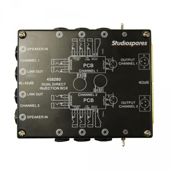

This problem has become far more common as more people choose to use powered speaker systems.
To give you an idea of why it happens. Imagine a triangle with a powered speaker at two of the corners and a sound card at the third. Now imagine the power cables for all three items connecting to a single point in the center of the triangle. No problem yet. Now we connect all three corners of the triangle together with audio leads and as if by magic you have a perfect example of a wiring setup that can generate ground loops galore. We have to break the triangle in a safe way by isolating audio screens/grounded connections to stop the loop forming. If you have any concerns regarding the quality of the protective earth/ground on your power outlet here is an example of a standard easy to use tester. It simply plugs in to your electrical outlet and will instantly show if the outlet is correctly wired.
If you can stretch to buying a Dual DI (Direct inject) box like this. This box wil convert from the single ended outputs on your Pioneer to a balanced signal to connect to the speaker inputs. This box provides total isolation between the controller and the amps in your loudspeakers. You would use this to connect the output from your controller to your amplified speakers. Use the Ground lift switches to break the audio ground and the loop should be cleared. In effect you are removing two sides of the triangle in one go.
Good luck

i finally received this in the mail only to found out this didn't work :'(
i may have to try DI Box, but the one you posted doesn't have USB input on it!?
