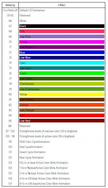

I've read the manual for the MF3D and got this:
First i want to look how the LED thing works, after that i will extend my mapping for every Knob and needed Function.
So i wrote a simple Mapping for just one Knob to figure out if it wokrs (but iit doesn't):
I found a hex to decimal converter wich says that the value 121 (velocity 121 = green cycle animation) is in Hex "79" and i added the value 0x79 in my device xml data sheet.
Did anybody get the MF3D running in VDJ with LED support?
Why does my simple Mapping not work?
Arcade Button LEDs wrote :
Sending a Note On message of the same pitch (note) as a given arcade button will overide the default
inactive/active color state of the buttons illumination.
The velocity of this Note On is used to set the color or animation for that buttons LED.

try mapping it to a more basic single color before you get into the animations, also blinking is done better in VDJ IMO...

give the LED's a 'value' as above
this should light up the button purple
<led note="0x2E" name="LED_PLAY" default="PLAY" value="71" channel="2" deck="1" />
if you need HEX use this, but I think Decimal will be fine
<led note="0x2E" name="LED_PLAY" default="PLAY" value="0x47" channel="2" deck="1" />
Posted Tue 22 Jan 13 @ 1:00 am
Alternatively, you can map each multi-colour LED as follows:
<led note="0x2E" min="0x00" max="0x7F" name="LED_PLAY" default="PLAY" channel="2" deck="1" />
You can then use get constant to set the value between 0.0 and 1.0 in your mapping, which will set the LED colour appropriately, e.g:
<map value="LED_PLAY" action="loaded ? play ? get constant 0.6 : cue ? get constant 0.66 : blink ? get constant 0.65 : get constant 0.0 : get constant 0.0" />
You'll need to change the values appropriately to get the desired colours, i.e: Green should be 76 / 127 = 0.6

It's working and my mapping is nearly done, i'm not 100% comfortable with it jet but i have to figure out some small details.
The Hz blinking was not working but it's already possible to make the leds blink via the VDJ-Script
I used the min - max idea wich the support stuff gave. Here is a little list if you want to use the colours:
- white: 0.520
- black: 0.528
- pink: 0.535
- low pink: 0.543
- purple: 0.551
- low purple: 0.559
- blue: 0.567
- low blue: 0.575
- cyan: 0.583
- low cyan: 0.591
- green: 0.598
- low green: 0.606
- chartreusse: 0.614
- low chartreusse: 0.622
- yellow: 0.630
- low yellow: 0.638
- orange: 0.646
- low orange: 0.654
- red: 0.661
- low red: 0.669
- rgb cycle: 0.937
- red cycle: 0.945
- green cycle: 0.953
- blue cycle: 0.961
i used the value="71" line and it works perfect, then i just picked the colors from the midi fighter 3d manual
i also have a spectra on the way and i'll be making a new mapping for it aswell. feel free to modify my mapping, or if anyone has any ideas let me know. i found it to be way easier to just pick your colors that you dont want to blink via midi fighter utility.
my mapping is uploaded but it still says pending review, so i guess it may not be availabe for dl, but here is the link i see it as:
http://www.virtualdj.com/addons/15620/Midi_Fighter_3D.html
also available here:
https://maps.djtechtools.com/mappings/1116
Posted Fri 25 Jan 13 @ 6:36 pm
