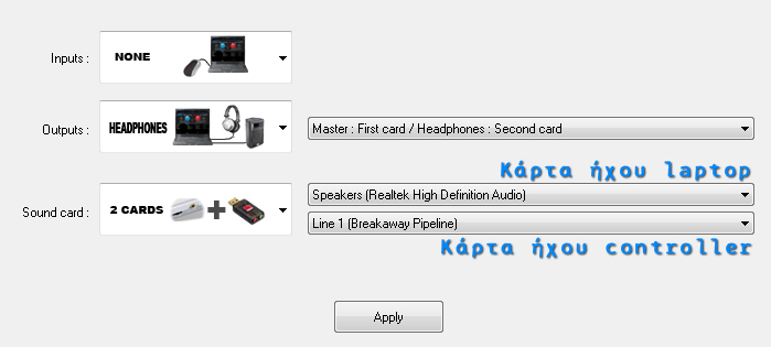

Ta pragmata einai apla...
Autos o controller DEN EXEI master out, para mono eksodo akoustikon.
Pou simainei oti exei mono mia basiki stereo karta hxou.
O tropos na ton doulepseis einai se syndiasmo me tin onboard harta tou ypologisti sou gia master.
Synepos :
Inputs : none
Outputs : Headphones
Soundcard : 2 CARDS - > Proti karta h onboard tou laptop, deuteri h akyinama usb oti onoma kai an exei.
Psaksto ligo kai tha doulepsei.
Synepos :
Inputs : none

Ksanabale tin karta se Stereo (oxi tetrafwniki) kai dokimase to parapanw SOund setup (sto screenshot)
