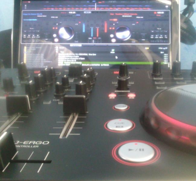

donde lo descargo la version 7.3 pro tengo ddj ergo v
Posted Sat 19 Jan 13 @ 2:00 pm
This is an English speaking forum. Please use our Spanish speaking forum, they will understand you issue better.
