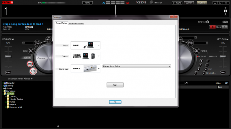

i followed this tutorial http://www.youtube.com/watch?v=WYEJ2BjzXoc and my sound was able to play through my computer speakers
but i am not getting any sound on the WeGo's headphone, how do i set it up so i can play through my computer speakers and listen on the WeGo?

You need to set up an Advanced Sound setup.
In Config->Sound setup, choose Advanced Setup from the Output options and click on the Advanced button.
In the new window, create 2 lines as ..
Master ....Your Computer's built in sound card ..outputs 1,2
Headphones ..Pioneer ASIO ..... outputs.3,4

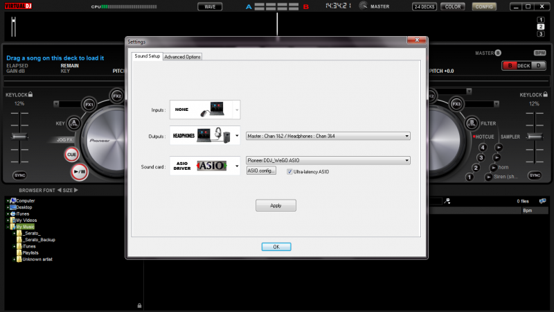

hey, ive purchased the pioneer we go and im having a problem with the headphone cueing,
what i hear from the headphone input on the wego is the same as the master output from the wego.. what are the configurations to headphone cue using the wego?

If you are using the LE version that comes with the WeGO , you need to connect both speakers and Headphones to the unit.
Sound Setup (in CONFIG)...
Inputs->None
Outputs->Headphones
Sound Card->Choose the WeGO icon or ASIO and Pioneer WeGO ASIO (if available)
Inputs->None
Outputs->Headphones

I am attempting to set up a DDJWego on a Mac to play over the computer speakers and headphones. The problem is that no configuration will remain applied. I've set the Output/Single Outputs, the sound card to Simple/Built in Output, hit Apply and Ok, and when you go back to Config the settings have reverted to back to Outputs/Headphones/Master: Chan 1/2, Headphones Chan 3/4. I can't get any settings to change. According to this pioneer video http://www.youtube.com/watch?v=WYEJ2BjzXoc (0:47) I understand that to be the proper configuration. What am I doing wrong?

My guess is that you're using the LE version of VDJ, which is preconfigured for use with the WeGO - and as such has the sound settings set for normal WeGO usage. Normal usage being with the WeGO output connected to an audio system, which is why it has onboard sound.
Posted Tue 09 Jul 13 @ 4:29 am
If that is the case (using the LE version), then it will auto-configure to Master/Headphones WeGO when the device is connected and your Built in Sound card when the device is not connected.
It is suggested NOT to have the WeGO sound card as default in your Audio Midi Setup.

For Windows users, you need to rightclick on the speaker icon on the bottom-right of your taskbar, and choose Playback devices. Choose as default the built in sound card of your computer (having the WeGo connected)
