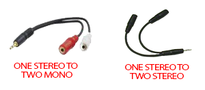

Because most stores will only stock stereo Y cables, for sending a stereo signal to two pairs of headphones.
What you need is a stereo-to-two-mono splitter, which divides the stereo signal in half and sends the left signal to one ouput and the right signal to the other. Most stores will not stock these, as they're DJ specific and not what 99% of consumers want.
You can easily distinguish which one is the mono splitter by just having the color code on the cable see photos below:
