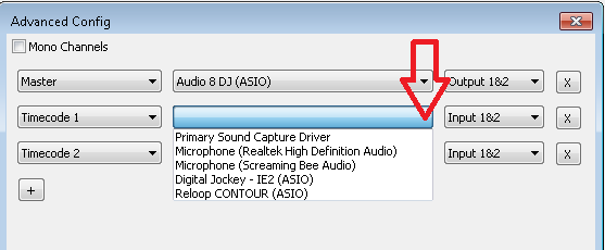

click the + to add new soundcard channels, then add the 2 channel outputs, if you see the picture it says "master" you want yours to say the decks, then choose the appropriate soundcard channels.

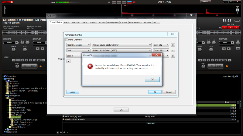

now it just keeps giving me a error message

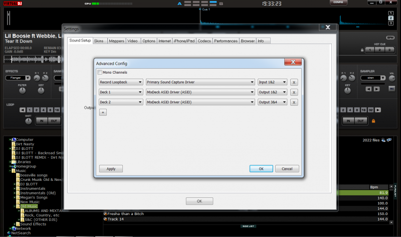

post a screenshot of the options you have, and can you edit it in paint... my screen is only 10 inchs

yea the mixer is definetely working and responding how it should when recording and just playing it in general. just the distorted sound im having trouble with now. i'll take a couple of pics on how my settings are
