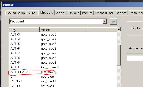

hi im using virtual dj 7 with laptop(windows) and idont have any dj contorler
my virtual dj is full and pro and when i use crossfader with alt+space not happen, crossfader dont move and stop
please help me how can i fix this??

Check your keyboard mapping to see if alt+space is still setup as you expect it
Also if you have a v7 pro license please input it's serialno on your profile, so everyone can see that you are a legit pro user
