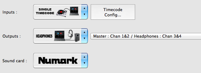

I believe its fully outdated to V7.05b as when i search for an update it saying i currently have the latest version.
I went through and reset all the mappings to the defaults and it didn't fix it.
I hardly doubt that its a hardware problem as the mixtrack has just come back from numark after having had 2 of the buttons repaired
the version of VDJ PRO is V7.05b and my OS version is OSX 10.7.3
here is a picture of my current sound config within the software: http://cl.ly/EMYj
Posted Sun 19 Feb 12 @ 2:33 pm

Who can identify the problem with the setup picture provided? And why Deck 1 won't play?

1- If you know how the site works, you would know that your answer won't hold: The only way to DL your Full Pro-version is through the Download Center at the left top of this screen. You'll only see a Full Version if you're a registered Pro User. So you do the math....
(And from a personal view:
Voluntarily give up the right to always be able to DL updates, plugins, skins, effects, etc.? OK....)
2- Your Deck A is waiting for a timecode-signal. Because the Mixtrack Pro doesn't have an audio-input it can wait forever. So maybe you should change the inputs-config....

Select advanced config in the output list and add the other two channels cause only 3-4 or 1-2 are activated at first!!
