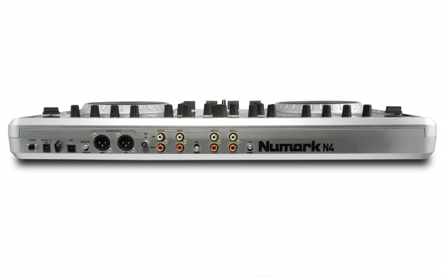

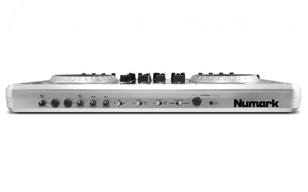

So, the front of the unit identfies the pass thru setting for the CENTER faders - which are Decks 1 and 2 - so these will HAVE TO BE your Timecode decks. The selectors (PC/INPUT) would allow you to get your audio direct from your CD players and play through the N4 on those 2 channels for standard Audio. When switched to PC then when using your Timecodes for controlling Decks 1 and 2 the audio from VirtualDJ's Decks 1 and 2 are controlled.
This then leaves the N4 control surfaces for Decks 3 & 4. So, yes; you could have Deck 1 or 2 playing a timecode controlled track and Deck's 3 or 4 controlled by the controller.
You are going to have no choice but to use the layer buttons ... why you make this such an issue of not touching a button is beyond me ... but, to get to opposing deck's FX controls you have to switch between layers. You are not going to find to many controllers currently on the market similar to the N4 that would allow you to do this. Now, Yes; there are possibly enough controls on the N4 that you could possibly remap some of the top buttons and knobs for direct access without changing layers. But, what you are describing sounds like you would need a dedicated controller mapped directly to controlling FX components - to make your workflow more to your liking.
But, in general; what you have described is very possible with this unit - except scratching on 4 decks all at the same time :)
