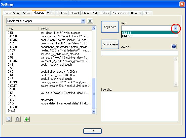

you can actually map it so when vdj recognises your controller it will perform the script. to do it you need to map "ONINIT" with this code
"deck 1 effect "effect_name" active on &"
eg.
deck 1 effect "filter" active on & deck 2 effect "filter" active on & deck 1 effect "reverb" active on & deck 2 effect "reverb" active on
soing it this way you are also chaining the path of the signal, so for instance you could use
gate --> crusher --> filter --> echo --> reverb
and the effects will operate in that order as long as you don't break the chain
this is how to find ONINIT
ONINIT%20vdj.JPG" border="0">
