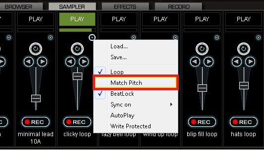

make it look like this and it will play the sample beatlocked without correcting the pitch.. meaning if your sample was recorded at 120bpm and you beatlock it to a 90bpm track it will lower the pitch of the sample, if you beatlock it to a 140bpm track you will raise the pitch of the sample
Posted Sat 14 Jan 12 @ 10:05 pm

you must be doing something wrong then, the reason I gave you that example is I tested just before posting, that was my result. With your samples you need to have the beatgrid set perfectly on the source, loop the track then press record.
All my samples are from producer sample packs, that is how I set them all up, this way the beatgrid information gets recorded with the sample so the loops play perfectly beatsynced to the active deck every time.
just to clarify
loop - on
match pitch - off
beatlock - on
just to clarify
loop - on
match pitch - off
beatlock - on
Posted Sat 14 Jan 12 @ 10:35 pm

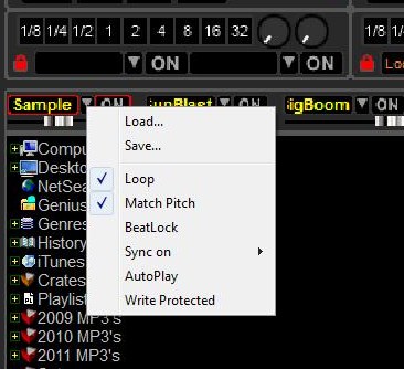

Heres how I have mine set,
I dont use beatlock cause when I scratch the sample scratches with me.
Huey
Huey
Posted Sat 14 Jan 12 @ 11:55 pm
