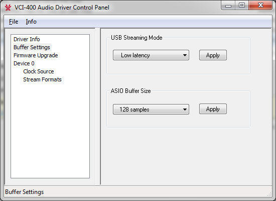

@sum.zero
Yeah that can be a bitch. Had it at first. This solved it for me:
- First of make sure you have the latest drivers.
- Second, look in your driver settings, under the buffer page
Choose Low latency under USB Streaming mode, definitely NOT Minimum Latency, that will fail, or at least on my machine.
Try a buffer size of 128 samples. If that fails go higher until its ok.
- For even more stable performance, set the virtualDJ proces in realtime performance mode.
I used to have an Hercules RMX (well still have :P) and for it to be able to perform I really needed to kill the services, kill the virusscanner, kill several hardware items, kill Areo, use high performance power scheme. With the VCI I start VDJ, put it in realtime just to be sure and don\'t change a thing.
I always play from files on a network share, over wireless, so that is kind of worse case scenario :P
Hope it helps!!

thanks for the reply. i don't think it's asio related as it's there regardless of any setting and even when there are no asio drivers present on the system [no controller, asio uninstalled, using windows drivers, even in safe mode]. if it didn't just start on both laptops i'd swear it was a ground fault... oh well, vdj's in a state where i can play out as long as i don't cue juggle and watch it with the effects. of course, that sort of defeats the purpose of having this beautiful instrument with all these buttons and knobs ;) i guess next i'll try re-installing my previous version on one laptop and see how that goes.
Posted Wed 07 Mar 12 @ 10:09 pm

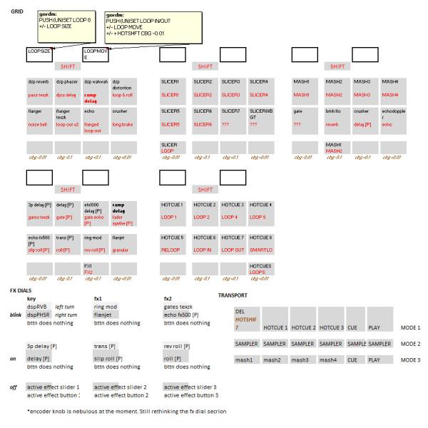

decided to redesign my mappping for the effects knobs at the top. now they are 6 dual fx [>50/<50] knobs for each deck and one default state of three knobs for the currently active effect on a single deck. i'm using teh pitch +/- buttons to cycle through and report states.
on the left side it works out to:
pitch- becomes deck 1 fx mode 1 [led on], 2 [led blink], and off [led off]
pitch+ becomes deck 3 fx mode 1 [led on], 2 [led blink], and off [led off]
they work in conjunction with each other allowing me to apply fx to one or both decks simultaneously and to have access to an fx knob for 12 primary effects for any deck at all times [don't have to hit deck switch toggle]. when both pitch buttons are off, the dials are sliders 1-3 on the active effect.
so far i'm liking this a lot.

doing a variation on the same thing with the filter knob and the assign buttons below them. going to set up a couple of different hp/lp, noise, and crusher combos that can be used independently or in combination [eg noisebell + hp at same time with both buttons set to state 1].
once i get closer to an actual 1.0 version of my mapper i'lll post it. still not finished all areas and code is a little messy in some places.

@synth i added your beatmasher 4 button combo from another thread [midi fighter] to the grid. i was wondering if i could get your slicer, jog fx and instant grat mappings to add as well? not sure if you've posted the code elsewhere in the forums.
i'll probably put something up *as is* later today. it won't be finished and will have some rough edges, but you won't have to wait on my slow self to finish... =)
Posted Mon 19 Mar 12 @ 10:05 am
ok. it's rough and i still need to put together some docs, but you can find the script here.
enjoy.

holding the hotshift button in the transport enables the cbg adjustment buttons in the grid mode buttons. also can be used to dleete hotcues in the grid and with the encoder buttons to navigate the pages [browser, sampler, etc].
the area below the main gain can navigate samples, record, and turn on/off beatlock:
sample- sample+
rec beatlock
volume slider

some additional notes on the mapping:
filter area:
the two fx buttons control how the filter works. they can be used in conjunction with each other to layer a filter + effect.
left button - on = default filter
left button - blink = lowpass texzk
left button - off = deactivate lowpass texzk + nothing
right button - on = left: crusher, right: noisebell
right button - blink = left: granular, right: gates texzk
right button - off = nothing
pfl buttons select the active deck as well as enable/diable headphone cue. not near my controller atm, but iirc the active deck blinks.
transport addendum:
the outermost button [delete hotcue] also sets a global shift variable while pressed. this can be used to:
- delete hotcues on the 8 button grid
- switch pages [browser, sampler, effects, record] by turning or pressing the browser encoder
- adjust cbg [-0.01,-0.1,+0.1,+0.01] by pressing the mode buttons on the grid or by turning the right encoder above the grid
the mash buttons in the transport section are mapped to the active deck and not side specific at this time. you can use either hand to mash your track. also allows one side to be in cue/play mode/global shift mode while the other is in mash.
upper fx area:
the tempo buttons are used to control the quick fx dials [just what i'm calling them] and can be used in combination. as per the diagram in my earlier post, they can also control sliders and buttons 1-3 on the currently active effect for the selected deck [deck select switch]. i usually will choose an fx using teh grid and then play with it using the dials/buttons.
top button is deck 1/2
on = fx row 1
blink = fx row 2
off = dials and buttons are active effect 1-3
bottom button is deck 3/4
on = fx row 1
blink = fx row 2
the encoder is mapped to slider 2 0%/100% and teh push/button is active effect on/off in quick fx mode.
that's all for now. i'll post the next version once i update the effects a bit, get teh code a little more clean, and hopefully integrate some of some more of synth's stuff. i also will be reworking the fx to use slots, but i need a skin with multiple fx slots and don't really like any of teh available ones that fit my screen. i mostly just chain them using memory and the led states now....
most importantly though, thanks to everyone who helped me get this together. couldn't hav e done it without your ideas and assistance.

played out a couple of times with slight variations on this mapping. mostly ok, but didn't like a couple of things and am eliminating some of the more kludgey code. still working on it...
anyone have awesome button or dial fx mappings they want to add [eg beatmash + delay freeze, etc]? just send them my way and i'll put them in. starting on doing this myself, but figure this will go more quickly if we all kick in.
