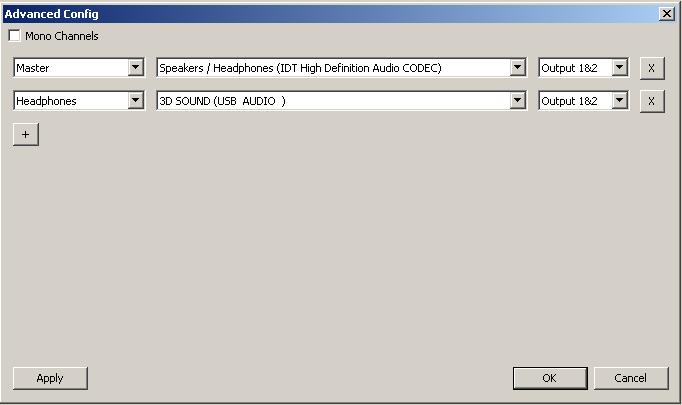

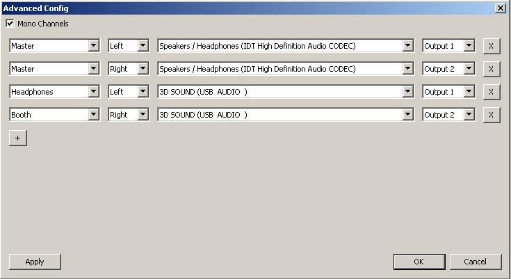

Joey, here you go. This is from my workhorse PC. Not my gig PC. But they display the same attributes. Whether it be my gig machine and a MAYA44 USB sound card or this machine with this setup; symptoms are the same. Samples are present in the headphones.
Posted Thu 30 Jun 11 @ 12:41 am
Morning Chris
I see the first problem is the "Mono Channels" check in the upper left corner, Uncheck that option, the sampler has to go to an independent sound card or a channel in your mixer for this to work.
Questions:

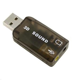

The "Master" is this your int. soundcard.?
The "3D Sound USB Audio is this a controller/soundcard..?
One more thing, does your controller have a headphone selector switch for A, B & Mix?
Thanks,
Joey....
Questions:
Thanks,
Joey....
Posted Thu 30 Jun 11 @ 8:31 am
JoeyKJ wrote :
Morning Chris
Good morning Joey.
I did. No dice. Same issue.
External sound-card only.
