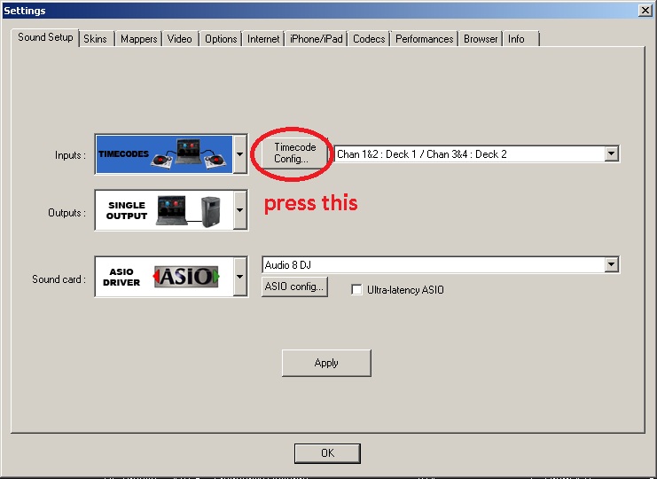

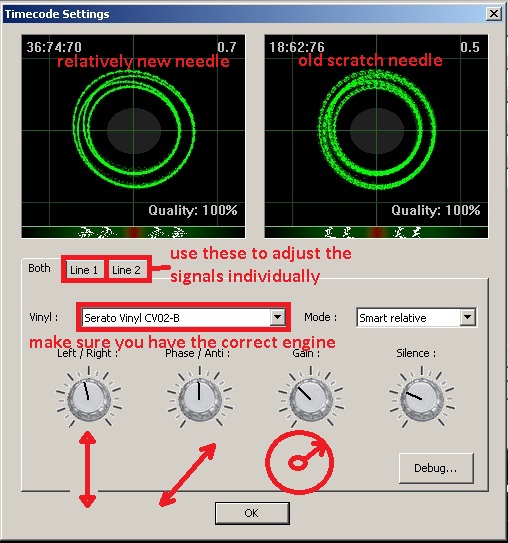

Hey guys, just want to thank everyone for their input especially beatbreaker you guys helped me out a lot with my first time setting up Serato timecode vinyl with Virtual DJ 7. My original problem was that I tried setting everything up myself and the signal was not steady at 100% and would range from 0%-100%. After I did all my settings the same as beatbreaker at page 3 where he showed screenshots my timecode vinyls sound great now at stay at 100%, even now when I backspin it doesnt sound like its losing signal and getting that crackling static sound it backspins smooth now. Even scratching now sounds great, I tried it with a few acapellas and doesn't seem to be losing signal like it did before. Also I want to mention that I am using the latest Serato timecodes with the small letters (black ones), so these were the ones that were giving beatbreaker a problem before but they seem to be working perfectly for me. Another thing I noticed was that when configuring my signal I could never get 2 circles, they would either go outside the box or look very blurry. After I did the exact setup as beatbreaker on pag3 it looks nothing like his screenshots but they stay at 100% which is strange, oh well I'm happy as hell though =) My setup was with a Technics 1200mk2, Technics 1210mk2, American Audio dv2, serato timecodes (latest) and Virtual Dj 7

this is my timecode config using m447's and serato cv02 side B "small lettering" says SCV - 12002 on b side in white
quality never leaves 100% unless I move the record which is what it is supposed to do.
timecode config 2.jpg" class="bb-img">
timecode config.jpg" class="bb-img">
