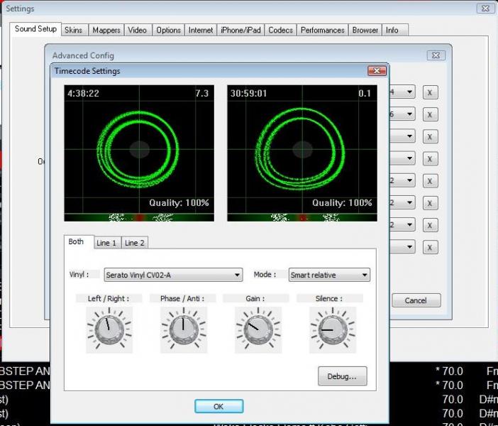

Turn the first 2 dials slowly. Make the circles as perfect as you can then post another screen shot and will go from there.

Hey Huey
I got them working ok, getting 100% and good circles on both decks, but, there is an annoying background tone on both decks (Left is louder) and I noticed I have to have my gain up to about 80% to get large circles....any ideas please mate? Cheers
Posted Wed 07 Sep 11 @ 2:37 am
The 'background tone' is probably the timecode itself.
You have to mute the inputs on your soundcard's (software) mixer so they don't pass through the outputs.
Sometimes this is called 'monitoring' or 'direct monitoring' (Depending on the soundcard)
Posted Wed 07 Sep 11 @ 5:59 am
Hi Asposis, sorry for delay been at away. I'm using the Hercules RMX.........where would I find that setting option??
Posted Tue 13 Sep 11 @ 5:03 am
Its at the bottom of your screen, right click on the little icon and open it. I don't have a RMX anymore so I can't tell you which it is exactly.

Cheers Huey, do you mean on the VDJ config or the RMX config, I'm not with the console at the moment........thanks...
Posted Tue 13 Sep 11 @ 5:51 am
On the RMX config... :)

OK, here are all my settings for perfect timecodes (well perfect for me, lol!)
Under Performances
Here is my timecode Signal window. Make them look like PERFECT CIRCLES or as close as you can

Here are my settings on the Debug menu
This is a shot of the ASIO Settings for my SL3
And these are the control records I use
Notice how these are the ones with the BIG lettering.........I cant get the other ones to work, I know theres something different about those..........
I also use the Numark timecodes aswell and I personally think they are even tighter but everyone uses Serato vinyl so here you go.
Any questions, just holla

I've had my odd bits to the door at the moment, most of my phono connections and the sound cards (due to not affording the Maya44) I spent all yesterday afternoon messing around with them when I returned back home from College, couldn't get the time code to work straight away. Because I have only the odd bits I thought I'd do some testing, downloading the MP3 timecode from VDJ, put it on my MP3 player and ran it through the sound card. Most of the time it showed a line which was annoying, which funny enough said 100% quality. After a few tweaks and rebooting of VDJ I eventually got the circle and VDJ began to spin the deck round smoothly, which stopped, and played when Pressing the play/pause button on my MP3 player.
Anyway just gotta wait for the rest of my stuff now, to say for sure if it'll all be perfect. My instincts tell me that things will work fine. Just the setting up is a bit of an ass!

I have been trying and will continue to try to get it working but I think my problem may be down to the fact that I have the NEWER CV02 records which as you stated may not work at all...
It was interesting to see that you had both "Invert" options selected - I'm not 100% how they work but hopefully I'll figure it out. Thanks.
Posted Thu 03 Nov 11 @ 5:52 pm
I think it might just have it working!
Need to test out a few more things but played a track on each side now WITHOUT PITCH CHANGING by itself. The key thing I adjusted as well as specifying everything Huey mentioned above was the pitch sensibility which is now at 2.14% and the lead time is 535.9ms (I guess these will be different for others depending on the TT used and soundcard but for me with Stanton STR8-150s and a RMX it looks good so far)
