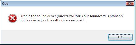

I just started getting the same message today (see figure below), but my issue is even worse - I have nothing connected to my PC, but when I launch the software, it prevents me from running the decks (I'm dead in the water now!).
All other programs work fine that use the sound card (Windows Media Player, IE, Audacity, etc.). I am running Windows Vista SP 2, 32 bit. on an HP laptop. Any ideas/suggestions? Could it be some update Windows did recently (maybe in the last 10 days) that may have caused a conflict with my built-in soundcard? If so, is there a utility to detect sound conflicts I could run?

Make sure that your soundcard, which you want to use with VDJ, is not declared as "standard" in windows audio settings.
Otherwise Windows claims it and so it can not be used by VDJ.

Please see our FAQ pages: http://www.virtualdj.com/wiki/Error%20in%20ASIO%20or%20WDM%20Sound%20Driver.html

OK OK I KNOW SO GO TO YOUR CONFIG BUTTON THEN FIND INPUTS SWITCH TO NONE THEN OK EXIT VIRTUAL DJ LAUNCH IT AGAIN AND IT WORKS

2. Make sure your ASIO driver is installed correct.

I had this same problem with an American Audio 14 MXR download and install "ASIO4ALL" driver it worked fine for me
I cannot say for sure it will work for you but its worth a shot :)

asio4all is just a emulation using your systems WDM driver on the pc side, and predending to vdj that it is a asio driver, having the high latency performance of the WDM Driver...i would not recommend that...

I had the same problem. Using Windows 8.0. This only started to occur when i installed VDJ 8. I still had VDJ 7.4 installed. I was getting the error in VDJ 7.4. I uninstall VDJ8. Still had the problem. I was using a Numark NS6. So i re-installed the NS6 driver after uninstalling VDJ8. That did not work either. You have to completely uninstall VDJ 8, and VDJ 7.4. Then i rebooted to be safe. Reinstalled 7.4 PRO. Rebooted again. Reinstalled the NS6 driver. Rebooted again. Problem solved. Yes, the whole time i had my laptop soundcard disabled.
