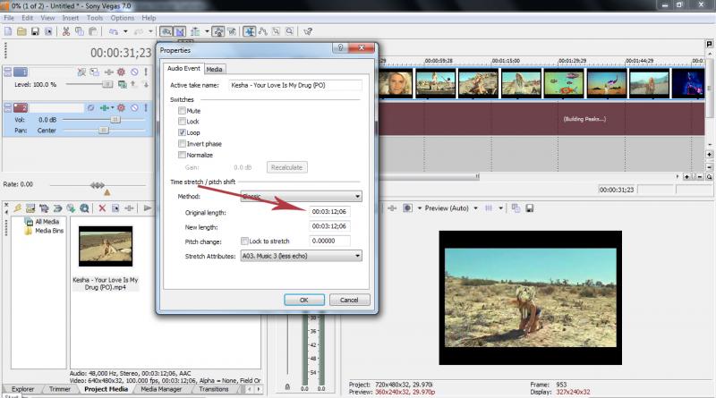

The remix you are trying to use is (127.9992) BPM but it's basically a totally different song (more than 7 minutes in length) compared to the commercial video which is just over 3.11 minutes long. It's not possible to do what you are asking without some major editing.
Replacing soundtracks which I do a LOT can take a minute or hours for me depending on the project. (I'm a self taught Vegas Idiot)
There are much smarter people than me here but this should give you a start
To change the BPM of a music track you go here, you can also "slow or speed up" the video to match the track by the same method which is sometimes easier.

HEy Renee - Beleive me I know what im in for as far as reconstructing the video. I tried typing in the bpm but it would only stay on beat for two or three counts and go off, i did not try slowing it down or speeding it up tho, ill mess with those settings

The best way I found in Vegas is by holding down the control key and drag the end of your video to match up with the audio (or waveforms) of your new audio track.
It may take you a while to get it just right...but once you got it edit away!

Ok correction...I have Vegas 10 Premium and the video envelope does NOT effect video speed...the Pro version has a similar option that works well. It seems all we have to work with is the Control key and drag the edge of the clip over to the left to speed up and to the right to slow down.

Indeed the control key and drag method worked perfectly! It took about 20minutes to get it perfect but it's there. Now I have to split and chop and copy and paste...long process but thats my own fault. Thanks for the help everyone!
