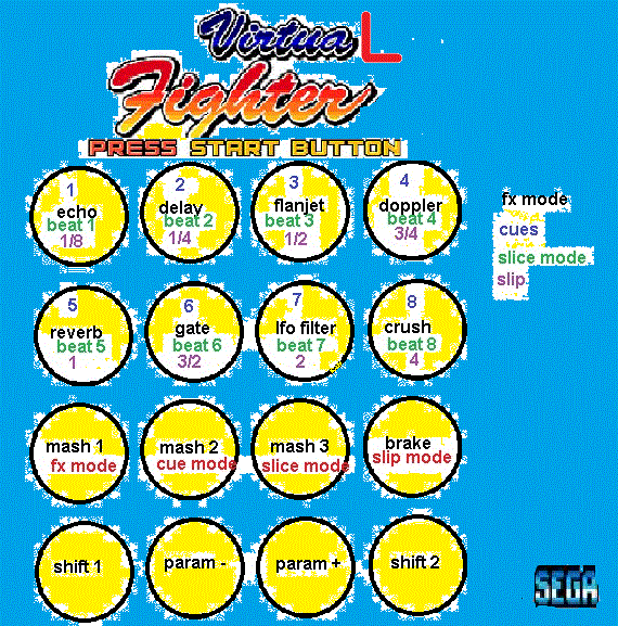

nice one, can you name the buttons as follows
Then use Midi Trace and hit the buttons in that order and paste the numbers here or PM me.
- ECHO
- DELAY
- FLANGER
- DOPPLER
- REVERB
- GATE
- FILTER
- CRUSH
- MASH 1
- MASH 2
- MASH 3
- BRAKE
- SHIFT 1
- PARAM -
- PARAM +
- SHIFT 2

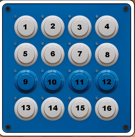

Haha, I saw your post as I came to post my results and have used a slightly different way.
I've started with my numbering at the bottom left so it looks:
(13)(14)(15)(16)
( 9)(10)(11)(12)
( 5)( 6)( 7)( 8)
( 1)( 2)( 3)( 4)
Heres the code:

also how do you think the hotcues should be laid out? Currently they are in buttons 9 - 16 this can't change, but whether they are decending or ascending can
(13)(14)(15)(16)
( 9)(10)(11)(12)
( 5)( 6)( 7)( 8)
( 1)( 2)( 3)( 4)
currently it is laid out like this
( 1)( 2)( 3)( 4)
( 5)( 6)( 7)( 8)
would it be better like this
( 5)( 6)( 7)( 8)
( 1)( 2)( 3)( 4)
making the controller operate like this under the cues shift
( 5 )---( 6 )---( 7 )---( 8 )
( 1 )---( 2 )---( 3 )---( 4 )
( L-)---( L )----(L+)---( B )
( S )---( - )----( + )---( P )
L=loop
P=play
(+/-)=pitchbend
It feels more natural to read the controller the way it is set now, but more natural to play the other way, what is your preference?

Okay, had a play. First up the combo buttons. If I press all the bottom row left to right I get a value of 8 as I press the last one. As I release the last button again I get the note off for 8. The row above gives 9.
Will post more details about the rest later as I'm at a gig at the moment.

do you have all the effects installed? otherwise that is really strange as i have that exact script on 4 different midi controllers on three different computers and no problem like that exists on any of my stuff...
what i mean is the top 4 buttons are hardware shifts for the midi fighter, the next 12 from 5 - 16 send different messages depending on which hard shift is in. so for example you would press button 1 then buttons 5 - 16, then change the hard shift by hitting button 2, then 5 - 16 again... it would be much easier for me if you can seperate the different shifts when you give them to me, but i should be able to work it out...
(1) (2) (3) (4)
(5) (6) (7) (8)
(9) (10) (11) (12)
(13) (14) (15) (16)
for the jogfx descriptions of wat i can give you check out this page
http://www.virtualdj.com/homepage/synthet1c/blogs/4680/Icon_Idj_Pocket_Controllerist_Manual.html
I'll be home tomorrow so i'll send em to you then, can you p.m. me your email..
