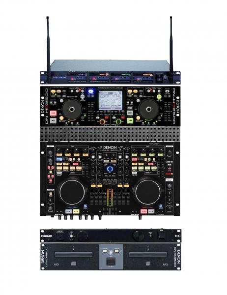

I wonder how fast it restarts if I really needed to. Would a quick on and off ruin the night if it were to happen? Would it be noticeable and would you recommend replacing a Hercules MK2 and a Denon DN-X500 mixer for just the Denon DN-MC6000, DN-H2500, and its BU-4500 CD player?
A little something like this:

Ok this is going to be hard to say, but i am using DN MC 6k with VDJ Pro and my friend has Cd Rack mount with cd players of course but i am wondering about the configuration in the options in Virtual Dj Pro, what i am trying to do is use it so i can hear the 2 channels on his that is going through my Denon Dn Mc 6k but i can't it seems to be some thing to do with the configuration, i have done all firmware updates, i just need to know the config settings for what i am trying to do because using the two outer decks changed to Aux 1 & 2 yet nothing from the headphones to pre-listen when i press CUE (PFL) on the Mixer.
@Dj Obedose: See the image its exactly like that and would like to know the configuration in Vdj

You must use your unit in "INT MIX" mode.
