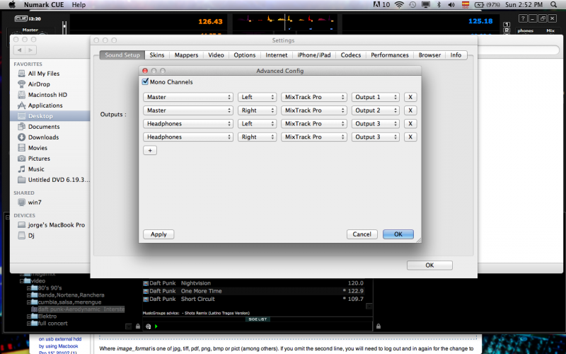

The best combination that works for me is:

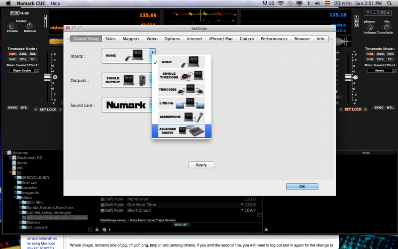

Go to sound setup and don't use the regular configuration, select Advance Cong.
Then you got 4 outputs ,
1.- select the mono channels option.
2.- add 4 channel
3.- In the first row select ¨MASTER¨, "2nd option select ¨LEFT¨, the 3rd one ¨MIXTRACK PRO¨ and the last one ¨OUTPUT 1¨
4.- In the second row select ¨MASTER¨, "2nd option select ¨RIGHT¨, the 3rd one ¨MIXTRACK PRO¨ and the last one ¨OUTPUT 2¨
5.- In the third row select ¨HEADPHONE¨, "2nd option select ¨LEFT¨, the 3rd one ¨MIXTRACK PRO¨ and the last one ¨OUTPUT 3¨
6.- In the fourth row select ¨HEADPHONE¨, "2nd option select ¨RIGHT¨, the 3rd one ¨MIXTRACK PRO¨ and the last one ¨OUTPUT 4¨
select Apply and its gonna work perfectly

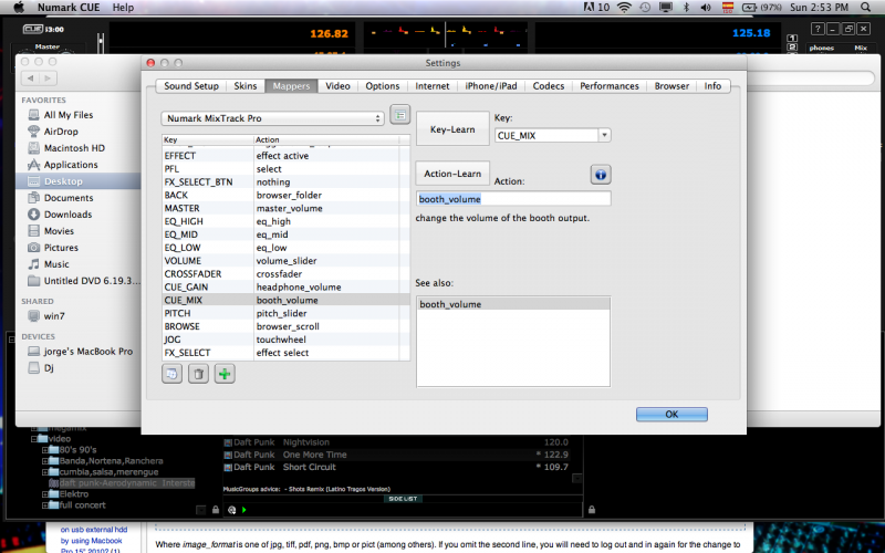

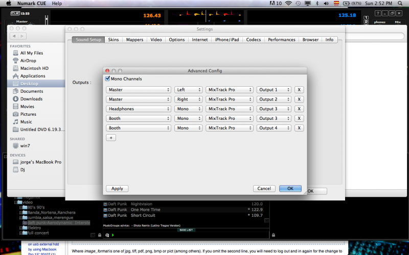

The cool thing about this configuration, is that you can play with the outputs you can choose channel 3 for headphones and 4 for the booth or whatever you want. Also in the mapper section you can change the CUE MIX to a BOOTH_volume so you can heard whats going on in the mix on you headphone and you external speaker.
2.- add 4 channel
