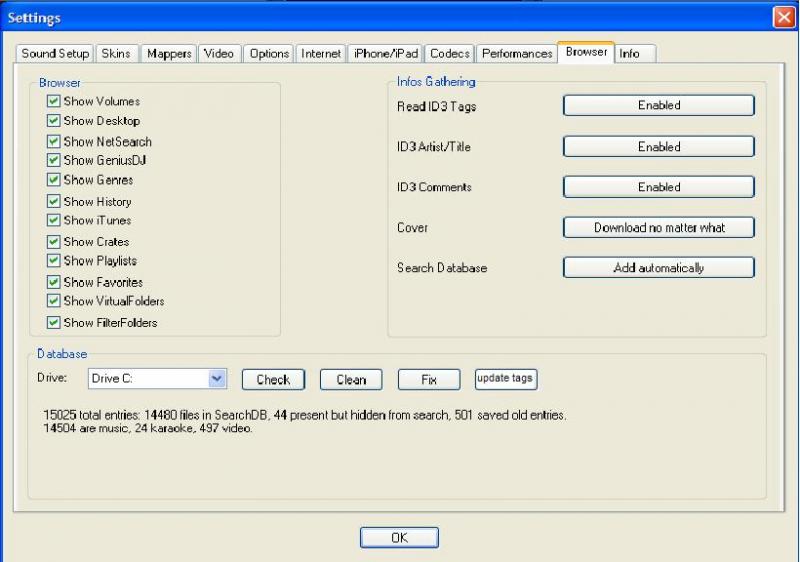

My opinion, this fearture could be put in the config. browser tab under database as an added option after "Fix" to "Update Tags" this would eliminate an operational problem that could ocure while doing a show....
Now in the browser, you could flag all the files you need to update tags, globally too (We Hope), but it won't write till it's initiated in the config. browser tab, example in image...

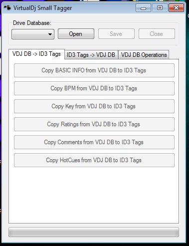

This works really Well, doesn't do video though, http://www.virtualdj.com/addons/15224/VirtualDj_Small_Tagger.html

Phantoms 'small tagger' is the answer you are looking for until the release of VDJ8, It can batch write the info from or to the tags and visca-versa.... Also I paused the video in Ace's presentation of the alpha version last year and in the advanced options there was an option of 'get key from tags'.
