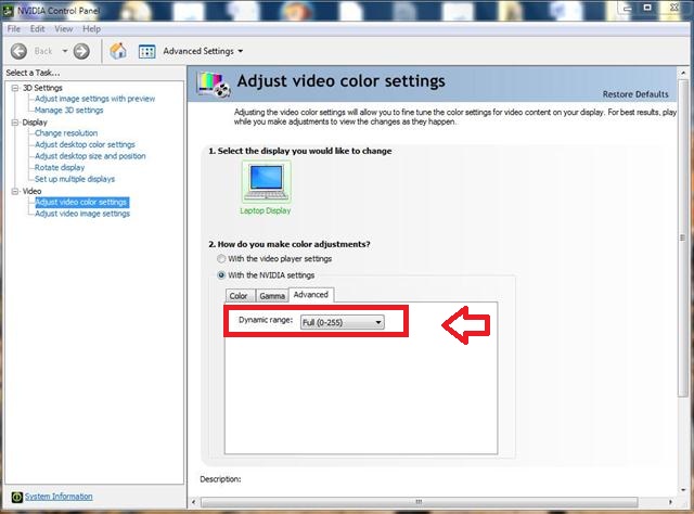

Color settings to change to get better quality
As by default the value is not right (limited mode), I do advise you to modify it
This happens mainly because Windows might work in Luminanace Level of 16-235 (TV LEVELS) instead of 0-255(PC LEVELS). Usually videos are stored in 16-235 YCbCr and is played back at 0-255 RGB so expansion is needed at some point.
The way to see the difference: look at the black border

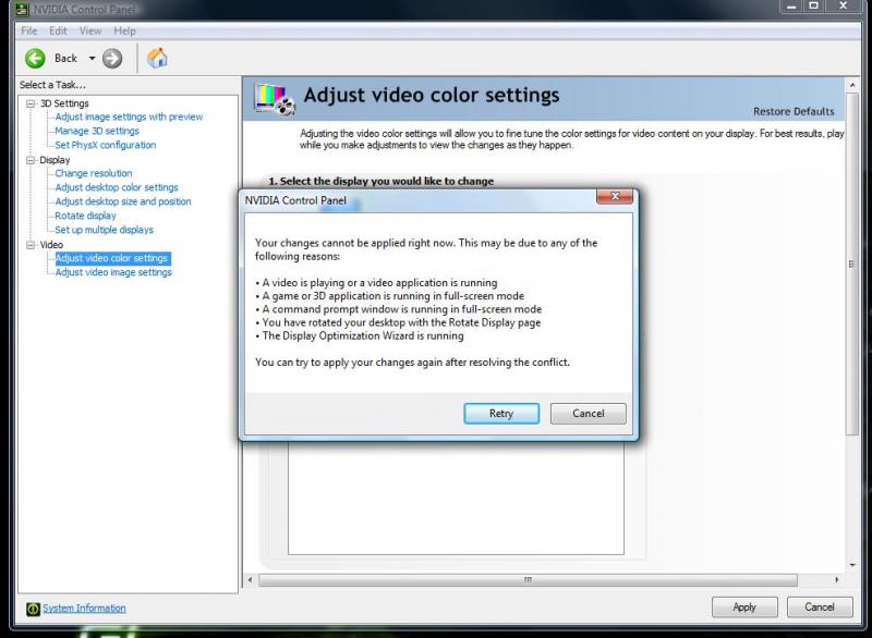

OK when I try to change it I get this error,
I have nothing running no other windows open...........
Any suggestions as to what I should do??
Thanks for the time
Thanks for the time
Huey

Except what is written on the message, there is no other reasons.
Check your processes in Task manager to see if you don't have something hidden in the background
