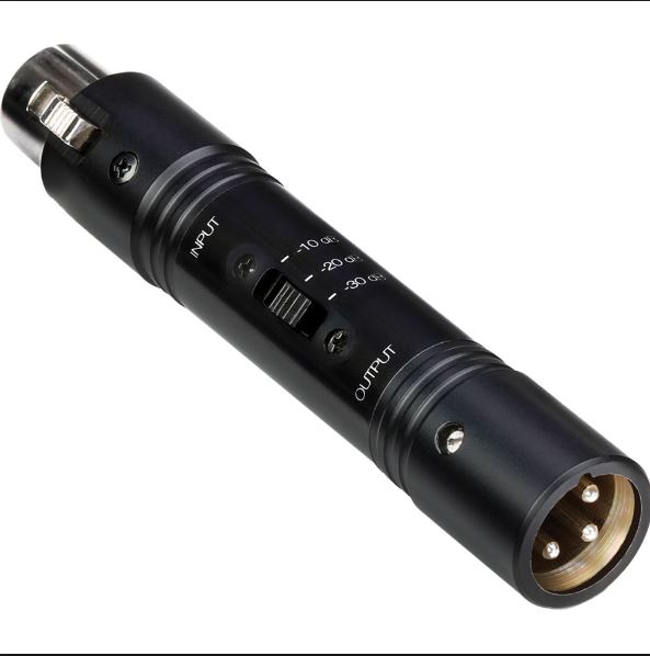

the denon mc6000mk2 has mic issues how do i correct them the mic runs hot
The mics are hardware controlled so it's not a VDJ issue. Get some attenuators like this.
The mic channels are sensative , but i have never had any problems, just turn the gain down, i have used cheapnand chearful mic, like kam and the industry standard sm series , never had a need for an attenuator.
The MC6000 Mk1 has known issues with the mic stage being poorly matched and therefore easily overloaded with standard dynamic and wireless microphone systems but the Mk2 has far better mic inputs. The attenuator above will certainly help with the Mk1 but unless you're driving the Mk2 mic stage with a hot radio mic you shouldn't need one.
The problem is that everyone thinks that turning the mic pots down on the MC6000MK2 is full kill, it's not. (It's -16, which on some mics that don't have an input gain limiter knob that's still too hot.)
Back in October of this year, I spent $25.00 USD on a Hosa attenuator (much like the one in the picture above) and it's awesome!
It also corrects the 'blaring' mic issue on the Pioneer SX and SX2 as well.
