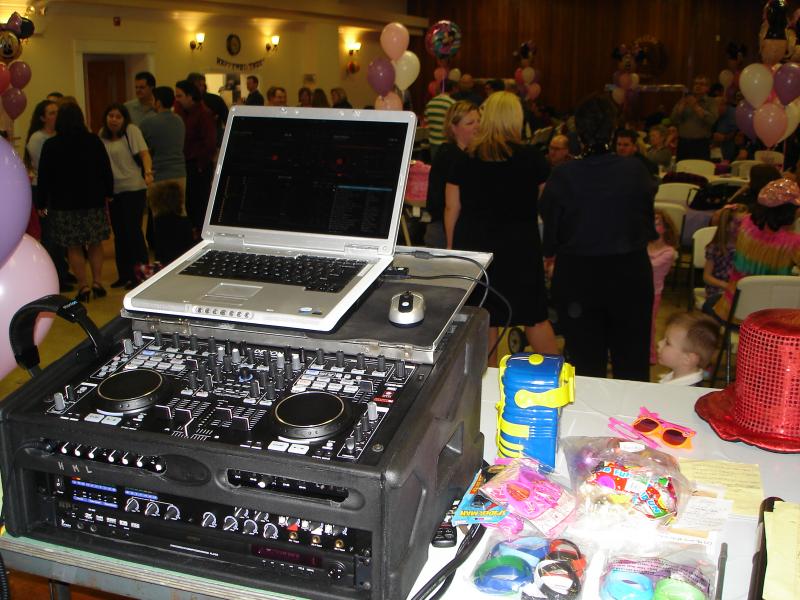

Both work awesome for me also!!! I\'m In Love with It!... VDJ & 6000 & special thanks to zacek100 for his work!
Rock\'n a 1st Bday party at age 48 like no other... remember boxes of cd\'s all over the table?
