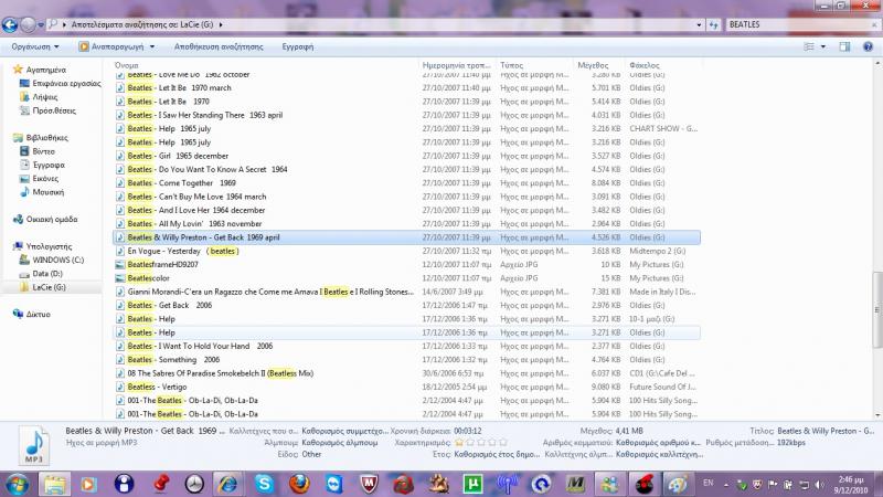

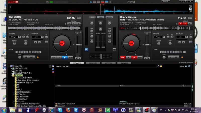

Φιλε DjDAD σε ευχαριστω πολυ για την αμεση ανταποκριση. Ολα αυτά που μου ειπες εχουν γινει, τα ξαναέκανα καλου κακου, αλλα παλι τα ιδια! Μηπως φταιει κατι αλλο?

Dwse mas ena paradeigma. Vres ena arxeio pou den sto vriskei sto search.
Kane ena screenshot apo to file infos autou tou tragoudiou kai episis pes mas ti vazeis sto search kai den sto vriskei.

Me sigxoreis den einai oti den akouo kai den sirgazomai gia na vroume tin lisi, apla epeidi to paratirisa, eipa prin kano auta pou mou eipes, na se rotiso kai auto. Den tha epanaliftei. Loipon apo kato sou exo duo scrreshoots, ena apo ton skliro mou opou emfanizetai to kommati ton bealles kai ena apo to virtual pou ekana search kai den to vriskei, kai den einai to mono, pistepse me einai paaaaaaaaaara polla pou den vriskei

an ola exoun apotyxei tote dokimase kati allo
1. kane backup ta arxeia database
2. pigene config > browser
read id 3 tags = disable
id 3 artist/title = disable
id comments = disable
cover = dont search
search database = add manually
pata ok
3. deksi klik panto sto disko sou sta aristera opos to blepei sto browser tou vdj kai "add to search db"
4. pigene sto browser tou vdj kai deksia pou exei to megethitiko fako kaneis klik kai epilegeis na exei kai to filename!
5. pata * stin anazitisi
tha prepei na sou bgalei ola ta tragoudia
6. 1 klik sto proto, patimeno to shift kai serneis me to pontiki to scroll mexri kato kai meta 1 klik sto teleutaio kai afineis to shift.
7. afou exoun epilegei ola tote kaneis deksi klik pano tous batch > title from filename
8. deksi klik panto sto disko sou sta aristera opos to blepei sto browser tou vdj kai "add to search db"
9. eisai etoimos
tora prepei na douleuei sosta

@alg1, kane akribos oti sou leei o djdad edo, tha einai pio eykolo na doume ta arxeia.
Apo ta screenshots pou anebases den fainetai tipota.
Ego tha hthela na do kai tis rythmiseis sou gia ta search options (to eikonidio dipla sto search)

paidia sas auxaristo para poli! ekana oti mou eipe o DjDad me tin database kai tora mou ta vlepei ola. An tyxon kati stravosei tha sas to po amesos!! Alitheia tora prepei na energopoiiso auta pou apenergopoiisa sto conf h na ta afiso etsi? Kai pali sas euxaristo para poli!!
