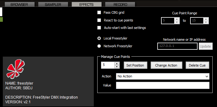

Been working on a little update to this following on from user feedback:
freestyler21.png" class="bb-img">
Any progress regarding these features? They would make this plugin even more awesome!
