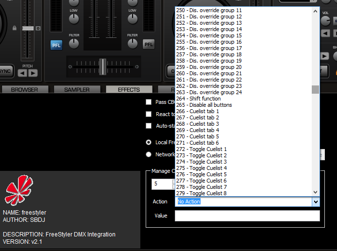

Been working on a little update to this following on from user feedback:
freestyler21.png" class="bb-img">
Posted Tue 30 Jul 13 @ 7:49 pm
