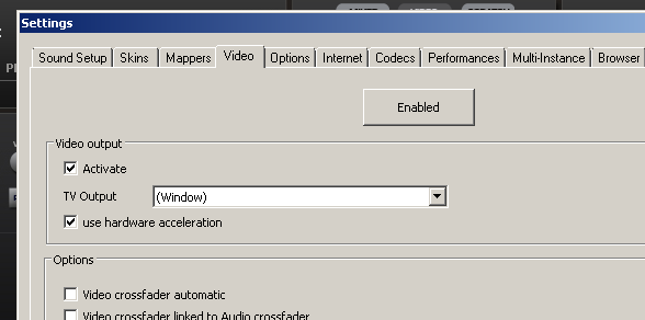

If your desktop is already extended to the second display, go into CFG in VDJ to the Video section. You will see a box that says "Window", click on it and under it you should see your graphics card. Select that and VDJ will send full video to the ext screen.

what if there is no graphics card that appears under that tab? because it only gives me the windows option.
Posted Sat 04 Dec 10 @ 6:35 pm
Then your 2nd screen isnt seen by Windows??
Posted Sat 04 Dec 10 @ 9:40 pm
If you have a video out on your notebook, or a video card on your desktop with a dual display, and you have a cable connected to either A: an external monitor or B:) an s-video, composite, component, or HDMI to a television or lcd. if the drop down menu doesn't have anything other than window, you either don't have the cable inserted correctly in one or both of the units, or you have a bad cable...

You will need to purchase the full VirtualDJ Professional to be able to display full-screen video and/or karaoke: http://www.virtualdj.com/buy/index.html
All other versions are limited to a small video window only - See http://www.virtualdj.com/products/comparison.html
Also, see http://www.virtualdj.com/wiki/How%20do%20I%20output%20video%20or%20karaoke%20to%20a%20TV%20or%20projector.html

I'm confused, if you have the pro version why haven't you registered it, maybe's that is why you are unable to get full screen output, try activating your license and let us know the results.
Posted Mon 17 Sep 12 @ 1:55 pm
Please register your Pro serial number on your profile page http://www.virtualdj.com/users/edit.html and then download the latest version from the Download Center: http://www.virtualdj.com/download/updates.html
If you were using Home FREE and have now purchased Pro but have not downloaded and installed it, then you may still be using the free version with its limitations, which is why you can't get full-screen output.
If you have not purchased VirtualDJ Pro then please support the software and its future development by purchasing it: http://www.virtualdj.com/buy/index.html
NOTE: The full VirtualDJ Pro is required for full-screen video output. If by 'pro version' you mean VirtualDJ Pro Basic then this is a basic version of the software and does not support full-screen video. Please see comparison. If this is the case, you can purchase an upgrade to the full Pro by going to http://www.virtualdj.com/buy/index.html
